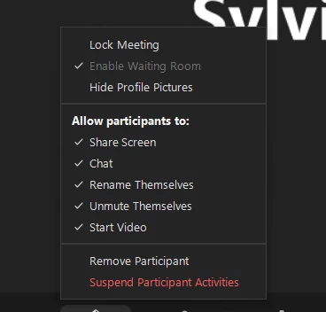

    May 17, 2022 7:34 PM UTC
    Hi Brandon! I appreciate the answer here about the ability to disable the waiting room during a meeting; however, I'm having trouble with that because the option is greyed out in the Security tab so I'm not able to toggle on or off. Do you have any ideas regarding this?
    YaBoiB
    May 18, 2022 6:01 PM UTC
    Hi @SylviaF,
     That tells me that your Admins have locked that ability for some reason, so you would need to reach out to your organization's Zoom Admins to determine why this setting is locked. Zoom does not lock settings by default. Only an IT team for a company or organization can do this function.
