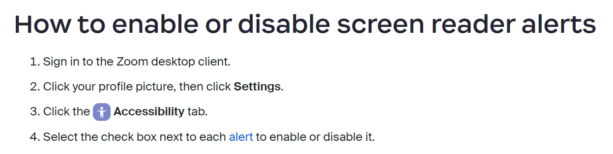

Hi, how can I turn off the sound of the assistant who speaks out loud every time I or someone else "turns on/off the recording", "starts sharing the screen", or "joins the meeting"? Even when I turned off Zoom from my laptop and logged in again, the "assistant" announced aloud that "the latest updates have been deployed to the client."
I couldn't find any options to turn it off in the settings, only: "Sound notification when someone joins or leaves", which is turned off.
I would appreciate any help.
bstrelko
October 24, 2023
It sounds as though you have Screen Reader enabled and you'd like to disable it.
More on Screen Reader Alerts here:
https://support.zoom.us/hc/en-us/articles/360048870451-Using-screen-reader-alerts
