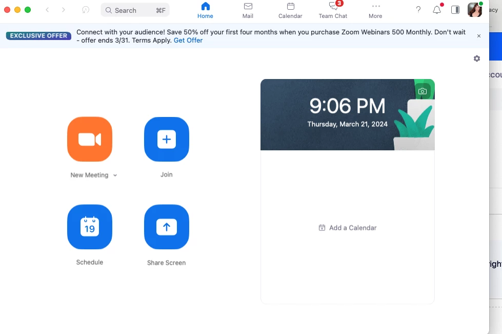

Marianna & Andrta, if you haven't already figured it out, I just discovered how to do it. You won't find the accessibility on the older desktop version, but you will find it on the Zoom pop up screen that appears right before you begin a meeting.  I've attached a screenshot of that. Click on your picture in the upper right hand side and then click on settings. On the left hand side at the very bottom is the accessibility link we've been looking for! For some reason, all of mine were suddenly enabled and I'm not sure why.  I had to click everything off and now it's not talking to me anymore. Whew! 🙂
