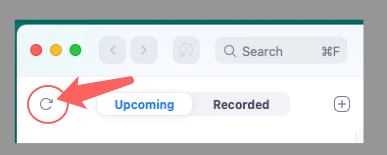

    @thm22  Can you try clicking the Refresh icon (Upper left hand corner in the Meetings tab)
    thm22Author
    March 2, 2022
    I did this. The client refreshes, but still all meetings are in the wrong time zone.  I clicked the + button there and added a meeting through Outlook, and then refreshed. The meeting is scheduled at 12:30 PM PST, then shows up in the Zoom client at 8:30 PM. The Zoom client is 8 hours off. (The computer is at PST which is UTC-8). Somehow the Windows Zoom client runs at UTC-0, ignoring the OS (Windows 10) time setting . There is no setting in the Windows Zoom client to adjust that, as far as I know.
