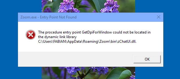

This is the 2nd error I get when I try to install Zoom on Windows 10.
I cannot tell if Zoom has installed or not.

    It appears that windows can not find the zChatUI.dll file. This can be from numerous reasons. Some of which includes not installing as a windows admin, interference from anti-virus software, bad sectors on the hard drive, missing distribution files, etc. Try uninstalling Zoom per https://support.zoom.com/hc/en/article?id=zm_kb&sysparm_article=KB0065146

    I have 3 older HP laptops running Win 10, 3 mini PCs running Win 10, a mini PC running Win 11, and a desktop running Win 11. None of these computers have any issue with any version of Zoom. The error you show is typical of issues with the Windows OS and not with Zoom. A little online research will explain how to resolve these issues with Windows.

    FYI I searched and found the Visual C solution that is recommended. But I want to know if it will install on my Windows 10 1511 first -- does anybody know what are the requirements for it?
    I have no problem going back to older zoom if  the update pack 1 won’t install on 1511.

    Try fully uninstalling Zoom first, then restart your PC and install the latest version again from Zoom’s official Download Center. Older Windows 10 installs often won’t update properly and just keep showing new errors until the old version is removed—Zoom support and other users report that uninstall + fresh reinstall usually fixes it. Also run the installer as Administrator and temporarily check that antivirus or low disk space isn’t blocking the setup.

    You confirmed that it is not a Zoom issue by stating you are using build 1511 and don’t want to update windows to the version that resolves your Zoom issues and closes a lot of security holes. Your next best choice would be to purchase a Windows 11 computer.

    I’ve installed the C++ redistributable SP1 as advised and the entry point errors still pop. What is worse, while the 1st time I installed Zoom 7.0.2 (BTW, the download says 6.7) it only issued the errors upfront but installed and worked, the 2nd time around it keeps popping the errors continuously. Weird.
    From this I infer that I gotta stop updating Zoom. I reinstalled 6.4.12 and will use it until it stops working, then I’ll switch to a free PD alternative.
