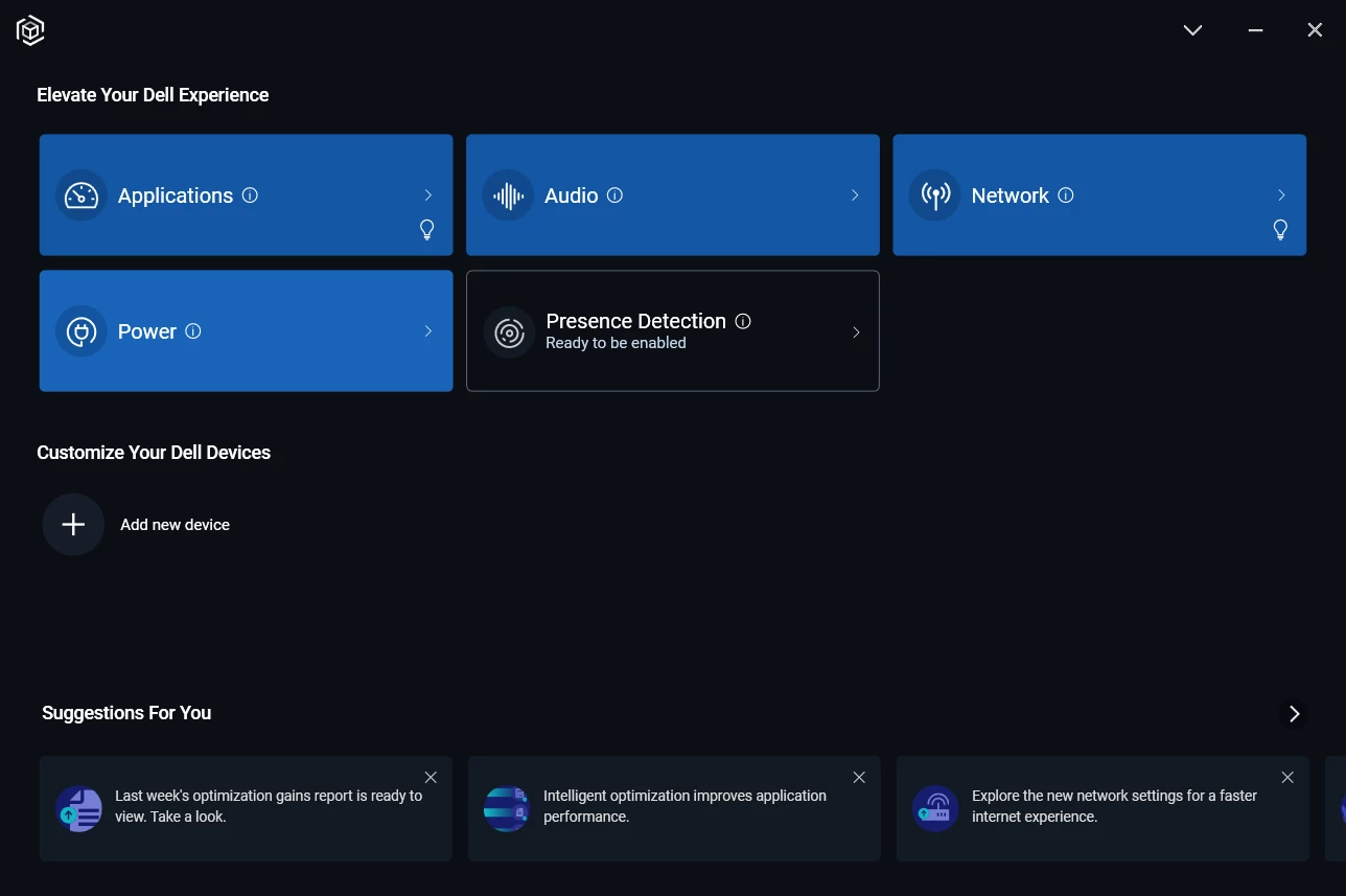

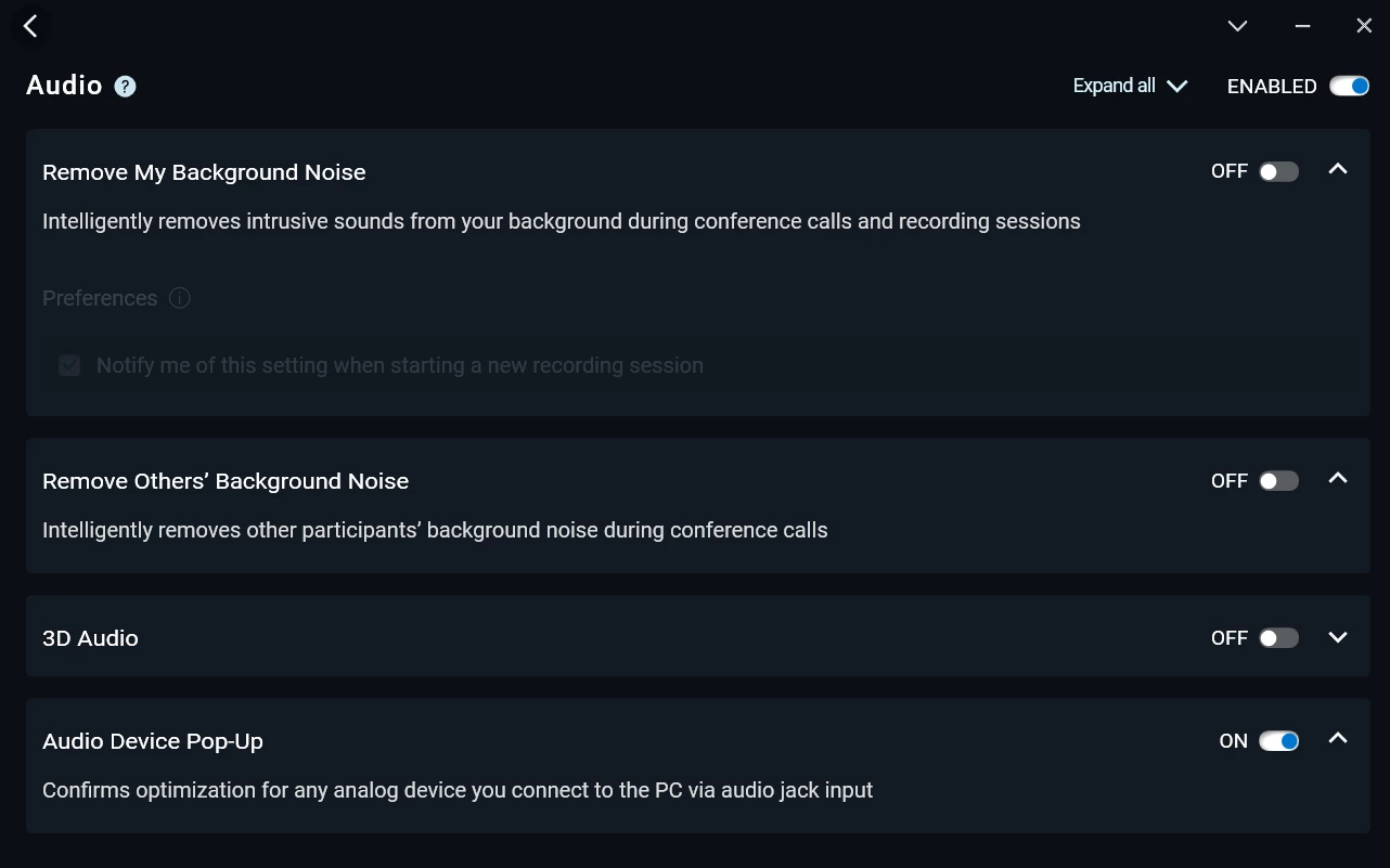

At the end I discovered that my Dell Latitude 5430 ceme with a Dell application called "Dell Optimizer" :
and entering in "Audio" and turning off "Remove My Background Noise" and "Remove Other's Backgorund Noise" :
 I finally solved the Zoom audio issue. Now it works well.
