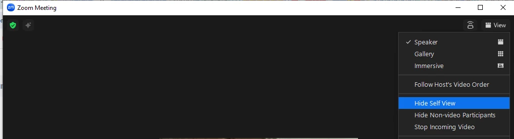

February 14, 2024
Record locally, pin the person if you still can and maybe select speaker view, and make sure to choose "Hide Self View" in the Meeting Window in the top right.
See if that helps.
