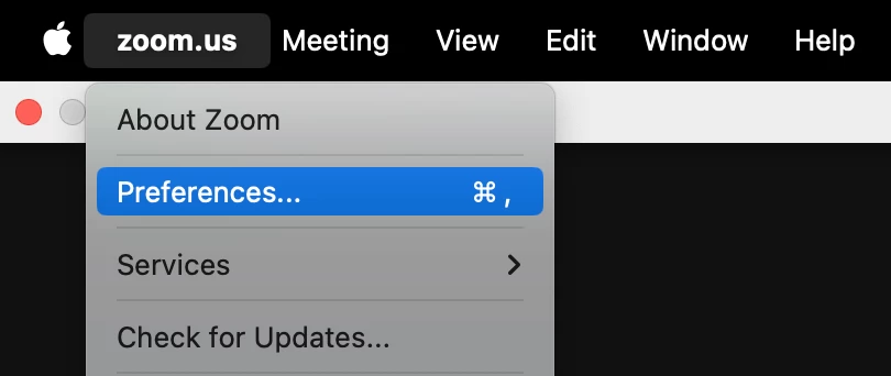

Annie84 and bstrelko... BRAVO!  But, I'm still silent with my earbuds.  I am exactly the same as Annie but I can not locate "Preferences in Zoom".  Does it matter that I utilize a non-paying account (no membership)?  It started as Annie indicated and like Annie, I can not hear through my buds while the internal speaker works like a charm.  Good for me but not for my wife at 7am.  Thanks in advance for helping a not-so-techie distressed wife!
bstrelko
Oct 31, 2023 8:24 PM UTC
If using Windows, please check out the solution provided for "zoom audio controls" , which outlines the steps needed to locate the settings menu for non-paid accounts on Win10/11.
If you're not using Windows, this can be found by launching Zoom on your Mac, then going to the top taskbar of MacOS and selecting zoom.us->Preferences:
