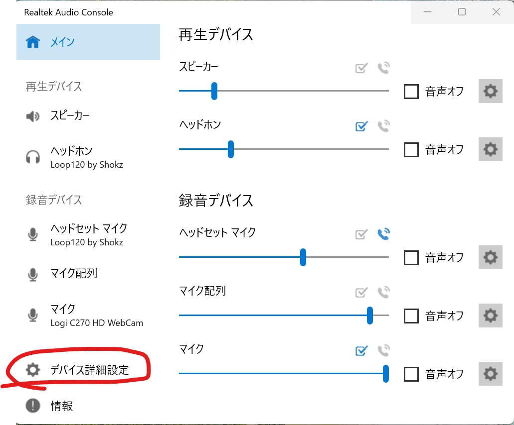

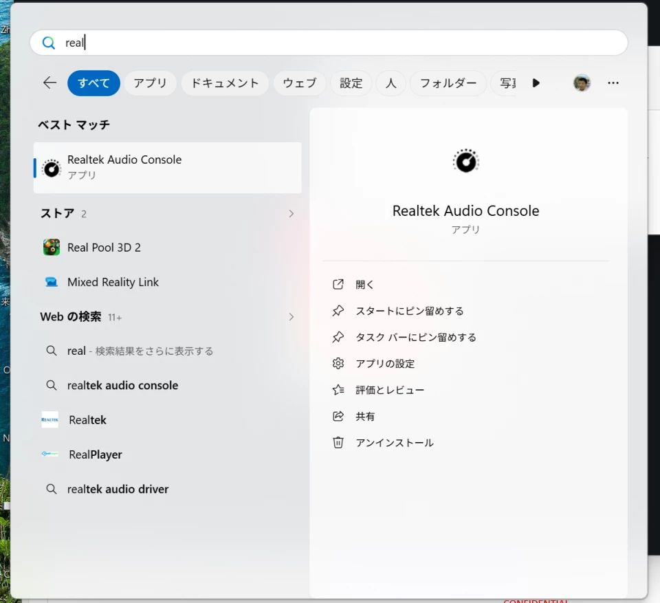

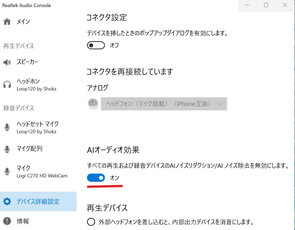

Aug 7, 2026 4:49 AM UTC
​@AykutKU2026
I recently figured out the cause.
If noise cancellation is set to “Auto” in the Realtek Audio Console app, you won't be able to hear the speaker test sound. You can hear it very faintly, though.
Since this noise cancellation feature filters out sounds other than human voices,
it can make it difficult to hear audio during online meetings, so I recommend turning it off.
Please refer to the attached image for specific instructions.
