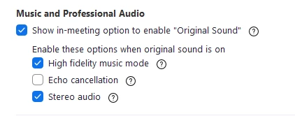

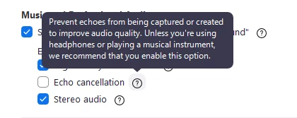

    As for the feedback, you should mute your Zoom mic while sharing the video, or you could enable "Echo Cancellation" in your audio settings to see if that will do the trick.
