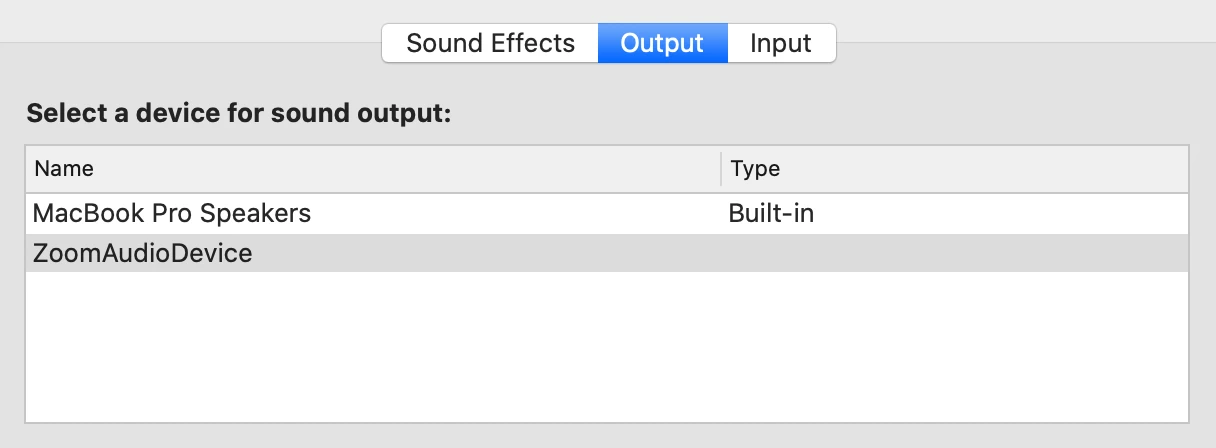

Unfortunately I'm trying to mute the audio from the outputting/sharing computer, not the receiving computer. While screen sharing with audio, if I try to mute or lower the outputting computer's speakers the shared audio is also muted or lowered. Strangely this happens even if the audio output is set to ZoomAudioDevice in System Preferences>Audio>Output. If I switch the output to MacBook Pro Speakers (the built-in speakers) the shared audio isn't heard at all from the receiving computer. But also strangely, sometimes when I've tested screen sharing with audio ZoomAudioDevice doesn't show up as an output option in System Preferences. Yet the receiving computer still hears the shared audio. In those cases the output is set to MacBook Pro Speakers.

I found that I could get this to work by muting the MacBook Pro Speakers device in Mac system preferences. So in total the setup on the sharing computer is:
1. Share screen
2. Check "Share Sound"
3. Make sure the program that's being shared has ZoomAudioDevice as the output device
4. Go to Mac system preferences and mute MacBook Pro Speakers. Do not mute ZoomAudioDevice
Nov 2, 2023 11:50 AM UTC
Sadly, I don't seem to be able to get this solution to work. The program being shared (Keynote) doesn't seem to have a program-specific output device setting, and in system settings, when I unmute/mute the ZoomAudioDevice it unmutes/mutes the macbook speakers and vice versa.
