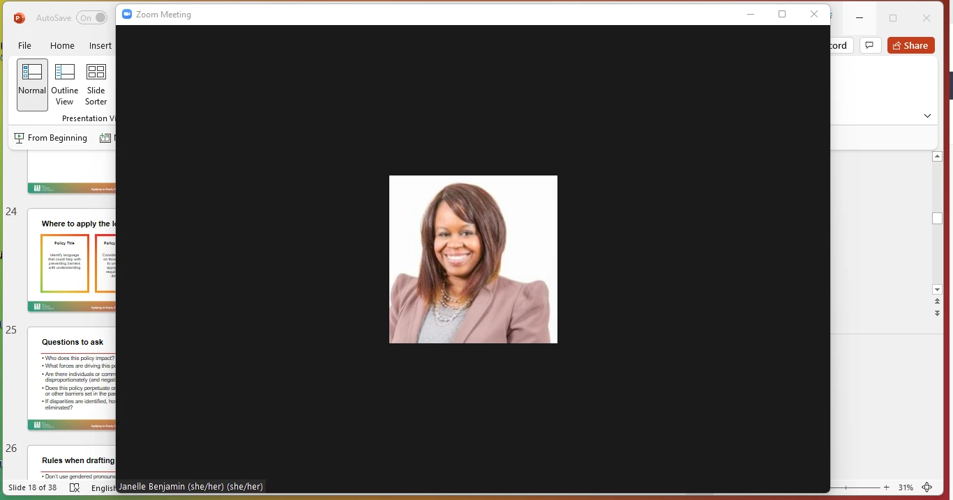

I have the same problem.  I'm on a PC not a Mac and I can't PIN my gallery so that it stays and I see my participants while on the screen.  This happens when I share a powerpoint presentation.  I'm a trainer and so I need to be able to see my participants' faces! Help!!

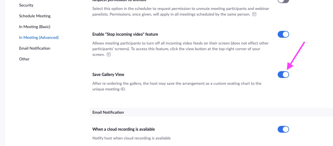

this sounds like a different issue. looks like you want to lock your gallery layout. im assuming this is in a meeting not a webinar and that you are the host. you can as the host arrange the gallery and have it save but if someone else joins or leaves the meeting it will adjust the gallery.
the setting for save gallery view, log into your zoom.us account page click settings- in meeting advanced - save gallery view.

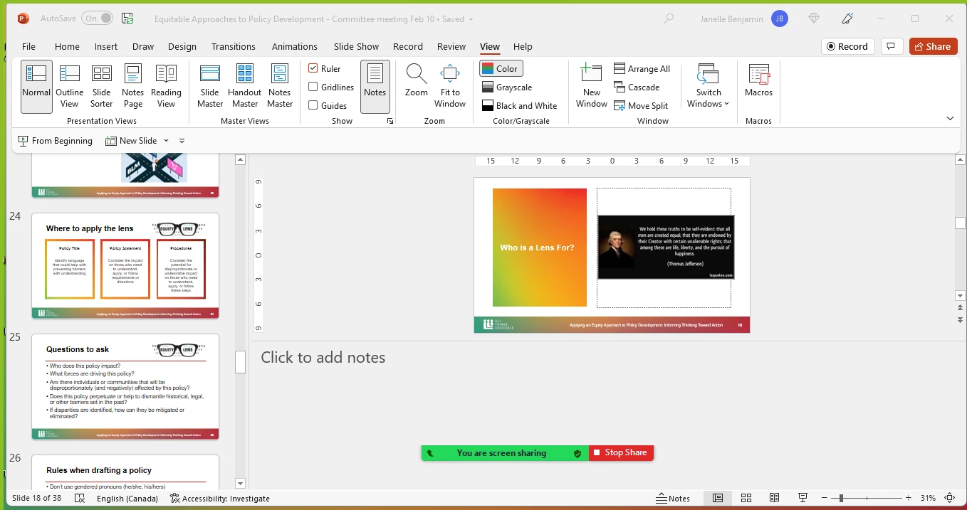

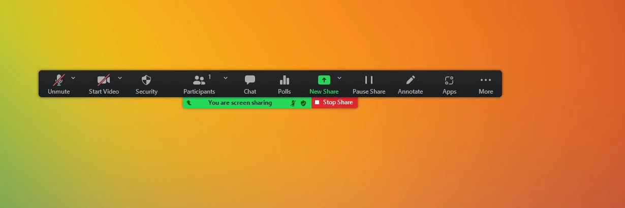

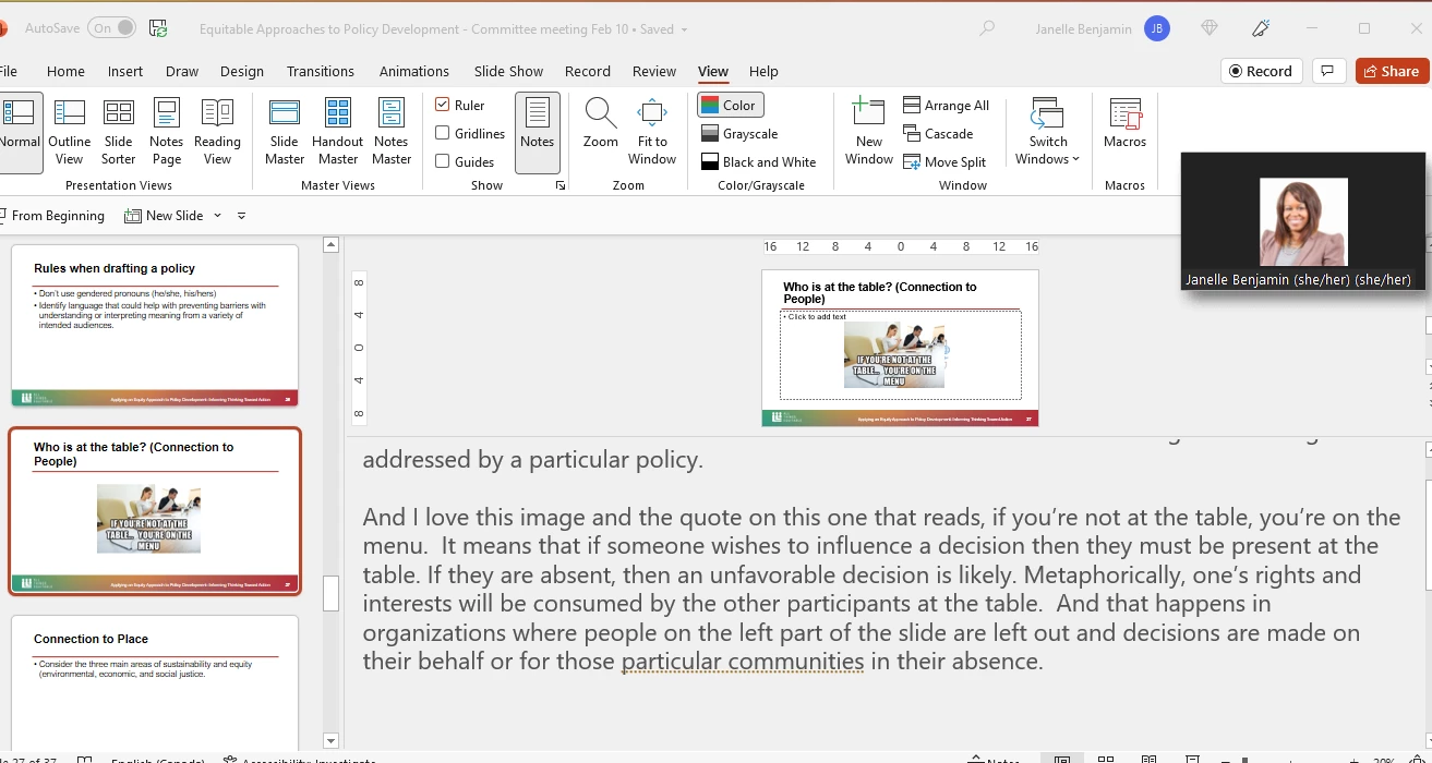

February 10, 2022
Thanks for your reply.  Tried this and it didn't fix the problem.  My problem relates to screen sharing of any kind.  When I share, the floating thumbnail of the room disappears and I can't get it back.  See these screenshots.  Snip 3 & 4 is what my screen looks like when I'm not sharing.

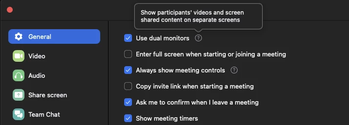

I would check to see 1st if you "Use Dual Monitors" setting checked in Zoom General settings. I attached a screenshot. Also on the Mac you may want to disable presenter view in powerpoint so that your powerpoint is on your 1st screen and your gallery view is then on your second screen.
May 25, 2024
Thanks Dan.  I do already have Use Dual Monitors selected in general settings.  I need to use presenter view when I give my presentations.  The odd thing is that it works fine on my laptop/external monitor set up but not on my desktop/external monitor setup and I don't see anything different about the way they are set up.
