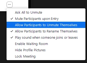

Hi, @Renay.
Don't worry, especially if this is to be an ongoing thing for you and your organization.  You'll have plenty of opportunities to "up your game" as time goes on.  I've been facilitating Zoom Meeting and Webinars for about 4 years now.
It seems like you might be working with attendees who are known to you and/or your organization, and hopefully are friendly and polite.  That will help tremendously, knowing that you shouldn't also have to worry about "crowd control" too much.  There's always someone who forgets to mute themselves; as the Host, you can mute everyone as needed.
On the ... menu of your Participants window, I'd recommend initially enabling the Mute Participants upon Entry option and disabling the Allow Participants to Unmute Themselves.  This will allow you to control the amount of "chatter" that goes on during the film.  You can enable the Allow Participants to Unmute Themselves option as you think prudent, but when it's time for the film, disable it and make sure everyone is muted.

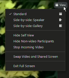

As the host, tell everyone that they can select the Standard View mode, and if all cameras are off, no one will be visible while the film is playing:

In a Webinar, usually your panelists (if any) will be compliant with your request to mute and turn off their video. Then you as the Host set Attendee View to Standard, and the film will display full-screen for all attendees. Hosts, cohosts, and panelists will need to set their own displays to Standard. In a Meeting, you can set Focus Mode – I haven’t tried this for film play out, so try this to see how it works for you.
