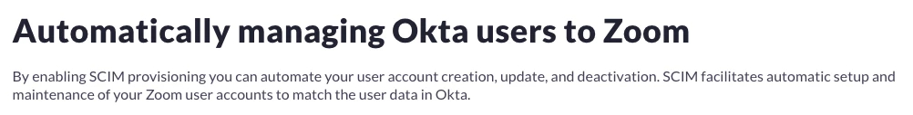

        Want to confirm you followed the instructions for the SCIM with Okta. For updates to existing accounts you would need SCIM. https://support.zoom.us/hc/en-us/articles/360059671292-Okta-user-management-with-Zoom
    I hope that helps!
