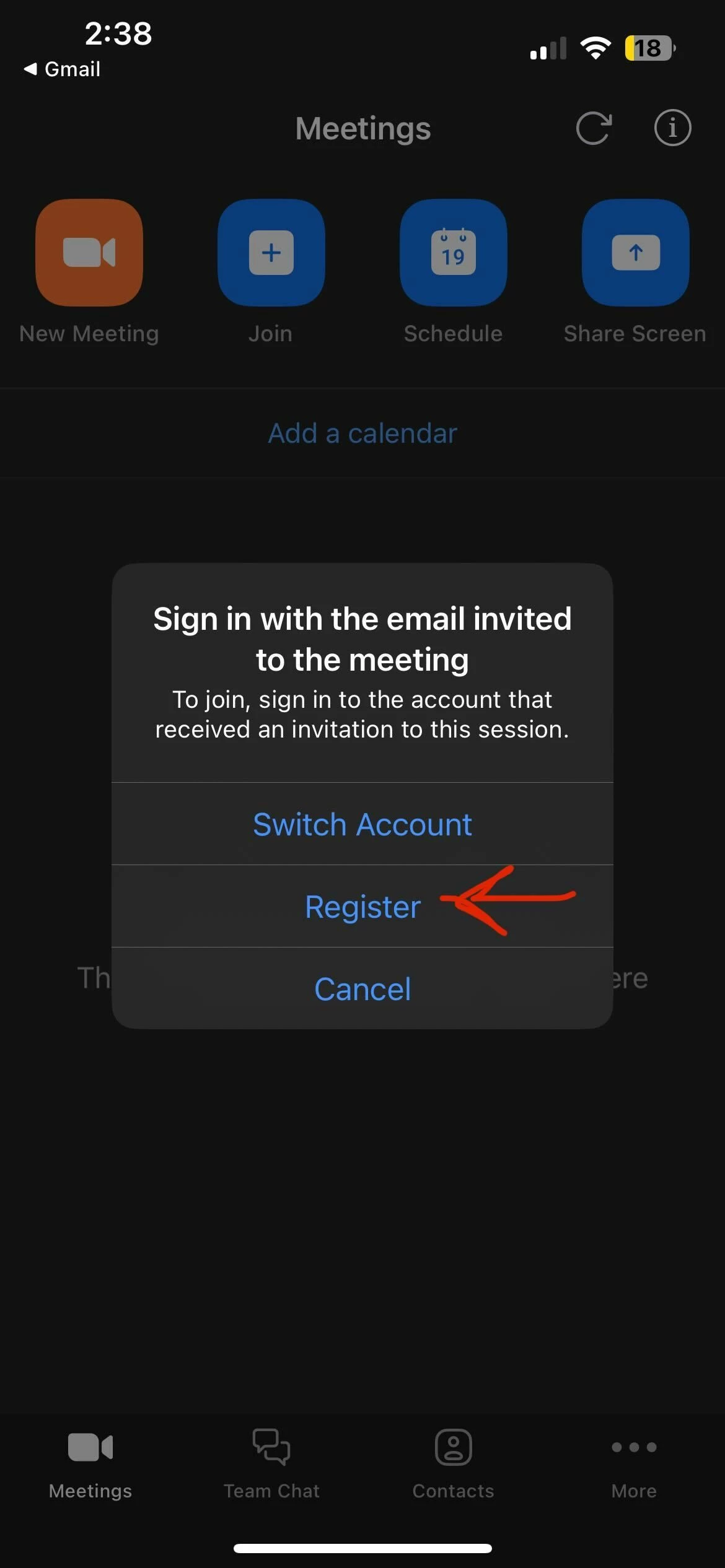

To specify, this is what it looks like when someone clicks the invitation link. Is it possible to remove the option for one to register on the spot?

Welcome to the Zoom Community, @2xJonny.
Manual approval should still be enforced after the meeting starts. You don’t indicate that approval is set to Manual; if you don’t have that set, consider setting it, so you can reject inappropriate registrations.
If you want early registrants to be automatically approved but prevent people from registering and attending after the meeting starts (or sooner), I believe you can change the approval mode from automatic to manual approval. I’d recommend making that change prior to the meeting’s start.  Please test this in advance to ensure you get the protection you’re seeking.
Note that in testing it has been determined that requiring registration and requiring authentication do not guarantee that only someone registered will attend your event. It is possible that someone obtains a registration link and connects with a Zoom account different than the email that was used in registration.
If you want the protection of knowing that attendance is only by registered attendees accessing the event from the same Zoom account as they are registered from, consider the Zoom Sessions or Zoom Events product. Let me know if you are interested in these options.

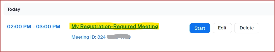

So the option to Automatic vs Manual approval isn't on the initial "Schedule Meeting" screen.  Go ahead and create your meeting with "Registration Required":
Then, back on your list of meetings, click the title of the meeting (not Start or Edit):

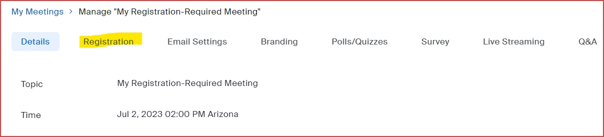

Then the Details tab comes up; click on the Registration tab:

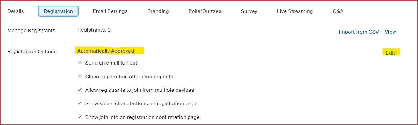

On the Registration tab, you'll likely see that Automatic Approval is the default setting:

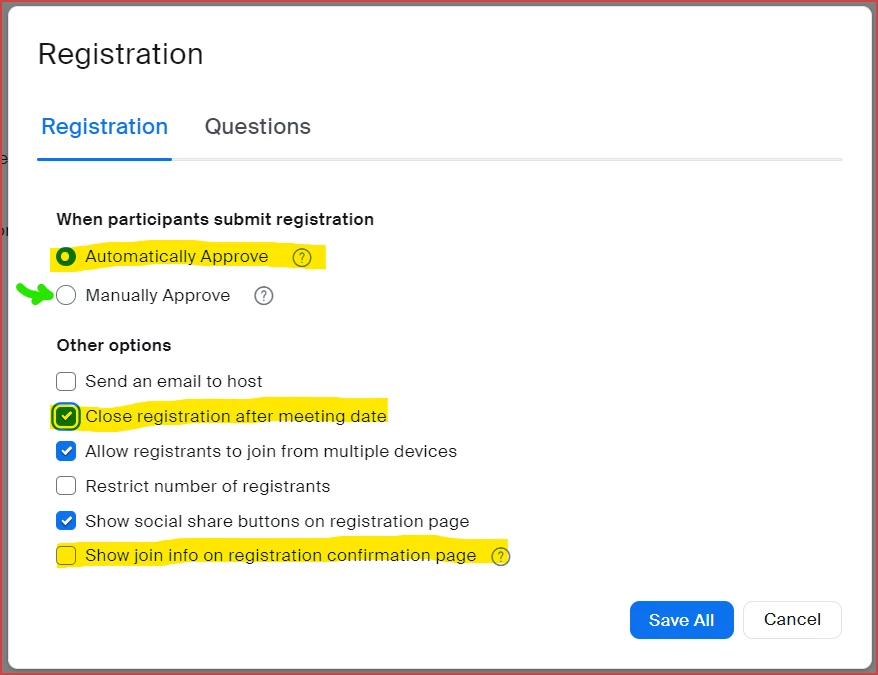

Click the Edit link to the far right to see:
My recommendations:
  • Leave Automatically Approved in place when creating your meeting.
  • Come back to this screen when you're ready to stop allowing automatically approved registrations and change to Manually Approve.  People will still be able to register... but they will not be approved.
  • I would recommend checking Close registration after meeting date. This will make the registration page inactive at the end of the scheduled meeting time.
  • I also highly recommend disabling/unchecking Show join info on registration confirmation page.  This will eliminate the issue of someone using a bogus email address to register, copying the join link presented at the end of the registration process, then joining the meeting after logging into Zoom with an alternative email address.
Click Save All once these are selected. Make a note to come back and change from Automatic to Manual approval when appropriate.
Again, I haven't tested this functionality in detail, but based on my previous experience, I think this is the setup that will give you the secure meeting registration and attendance you're seeking.
