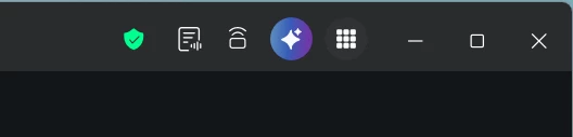

    This happened to me as well. I am an enterprise user and now that my company’s IT set AI companion to be automatically enabled, the record button is no longer visible in the top tool bar.
    Unfortunately I learned this today when I went to retrieve the link to share a video recording with my client. It was then I discovered, the last meeting it automatically recorded was February 11.

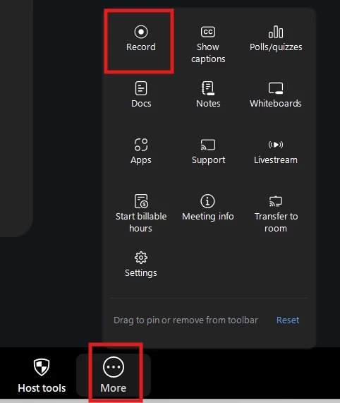

    After an hour of searching, I was able to find the record button hidden behind the “More” menu at the bottom of the screen (2 icons to the right of the Share icon). After it is selected, you also have to choose local or cloud storage. An additional task with 3 extra clicks per meeting because the record button was removed from the top task bar.
    AI is supposed to provide an efficiency gain. AI companion’s transcript and summary being “close” is not good enough to document details of a technical conversation. I relied on the recordings to fill in important details AI got wrong or simply excluded.
    In short, zoom’s AI companion has made me less efficient and I will be requesting our IT team disable the automatic AI companion feature on my account until the record button is restored in the top tool bar.
    Top bar with no record button
    Hidden in More menu
    After navigating to the bottom to select More, then select Record, then choose cloud or local recording.
