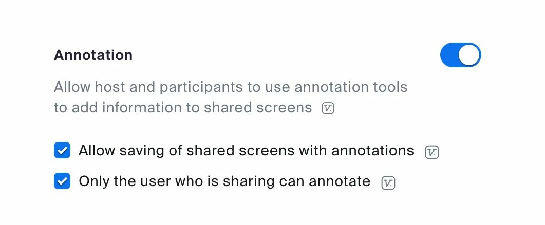

    From what I can see, sir, I think someone in your attendees has found the Annotation tool and proceeded to scribble on your presentation!
    I recommend going to the web view of your account to Personal -> Settings and turning off the Annotation tool, or at least checking the Only the user who is sharing can annotate check box.

    Hi, @alanterrill,

    Many thanks - I wasn't aware of this function, let alone that an attendee could access it !  I'm sure they had no clue as to what they were doing.
