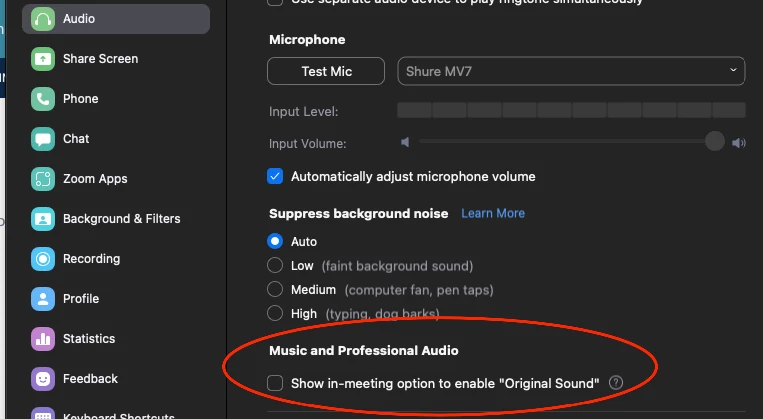

    Hi Joseph,
        There is a setting that may help. Under Audio settings you'll see Show in-meeting option to enable "Original Sound"
    More on the setting here: https://support.zoom.us/hc/en-us/articles/115003279466

    Hello Tom,
    Thanks for your reply. I tried this, as well as the other settings (high fidelity music mode, echo cancellation, and others), with no change in the popping.
