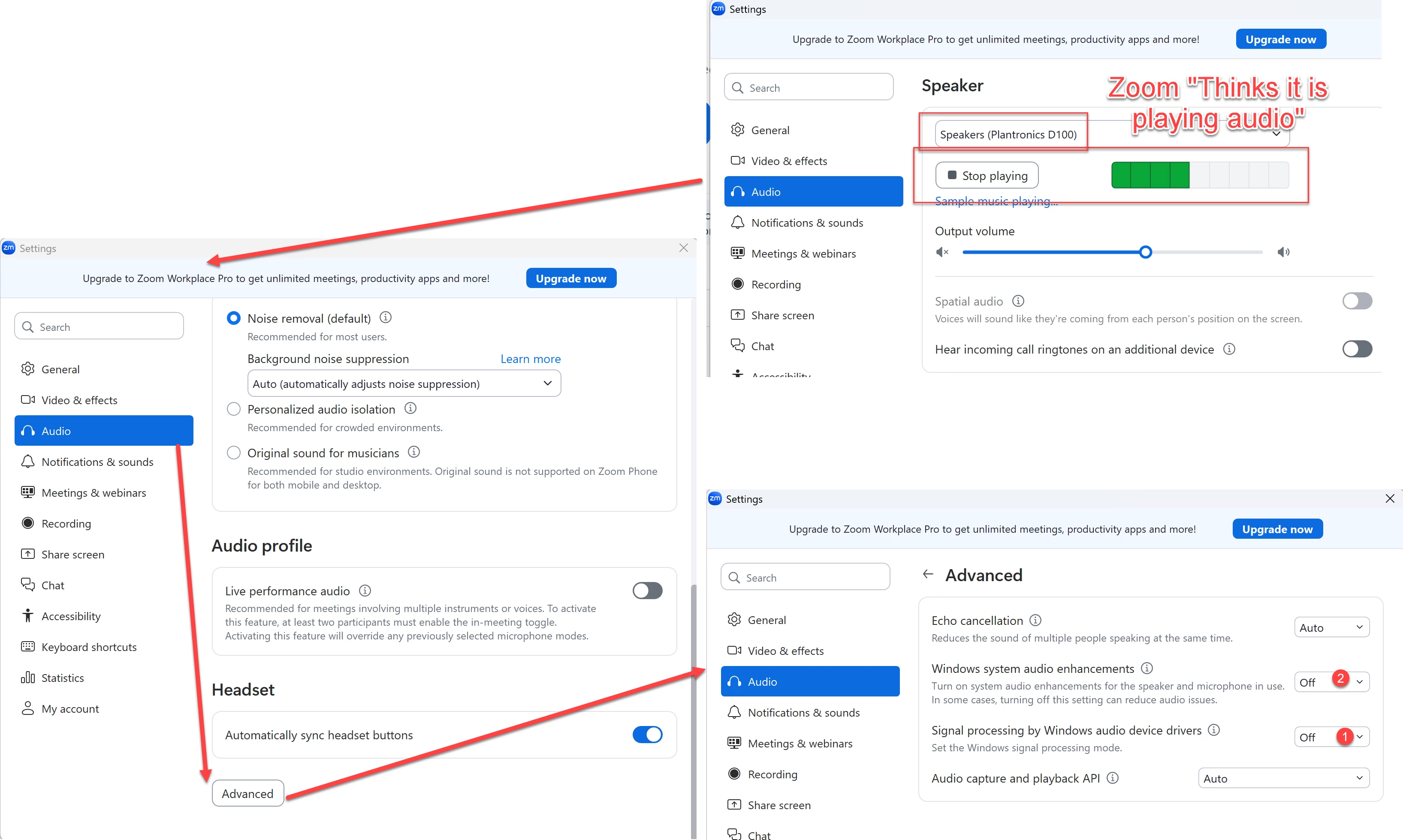

I finally solved this.
Click on up arrow next to Audio ^, then select Settings.
On the Audio tab, scroll to bottom and click the "Advanced" button
Disable either: Signal processing by Windows audio device drivers - OR - Windows system audio enhancements
Turning off one or the other solved the problem for me.  The "Windows system audio enhancements" indicates that this setting could impact other software, so I turned off the "Signal processing by Windows audio device drivers".

Sep 16, 2026 3:39 PM UTC
Found this post, and it worked perfectly for my Plantronics D100. It was maddening: Zoom THOUGHT it was playing audio, but in fact, it was getting eaten by those settings. THANKS AGAIN.. Confirmed for me. Here is a screenshot with exacting step by steps for those who might need them in the future.
