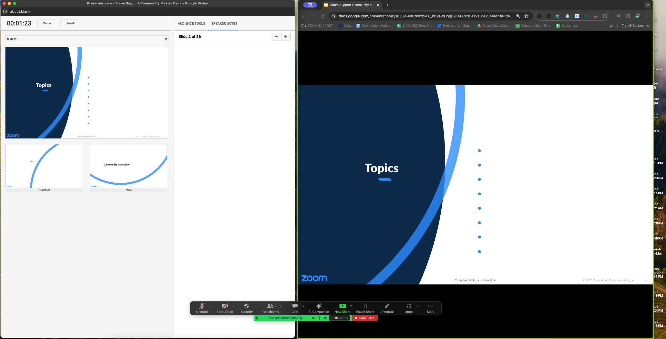

Hey @floatyboat @PublishOrlando welcome to the community! I was able to follow along this Youtube Video https://www.youtube.com/watch?v=ICziGs1ZzSY on "How to Share Google Slides in Zoom with 1 Monitor (Presenter View)", was able to replicate successfully.
Sharing Screen, I shared the tab that has the presenter mode full screen for participants POV. On the left, I pulled up the notes and slides to toggle forward and backwards.
From a POV for participants, they will see your slides without the shared notes. Hope this helps!
