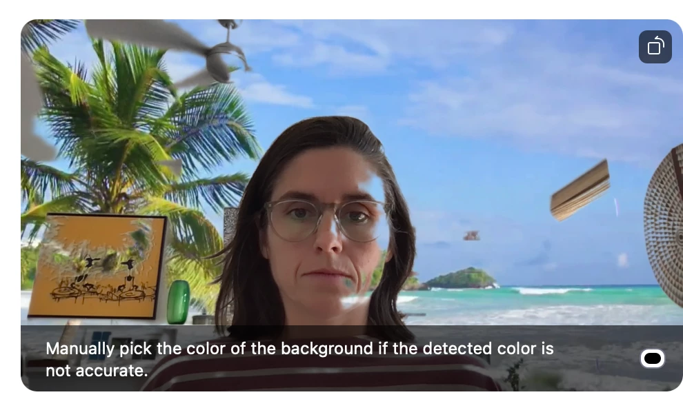

patchy virtual background
Whenever I try to use a virtual background, it is patchy and doesn't cover much of my room. See image, where you can still see my art and fan and part of my face is covered.
My room is quite bright, but I have also tried lower-light situations. It's always the same. My zoom is up to date.  Any suggestions?

    I figured it out! I had "I have a green screen" selected. When I unselected that it worked perfectly.

    cclalondeAuthorAnswer
    September 21, 2022
