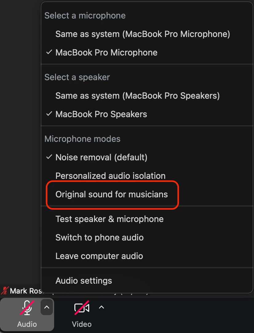

Welcome to the Zoom Community, ​@SUSAN BOOKHEIMER! I’m sorry for the late response. When you are in a meeting, you can click the arrow on the audio and from there you can select the original sound for musicians.
Apr 9, 2026 4:05 PM UTC
I also do not see it.  Please we need it urgently
