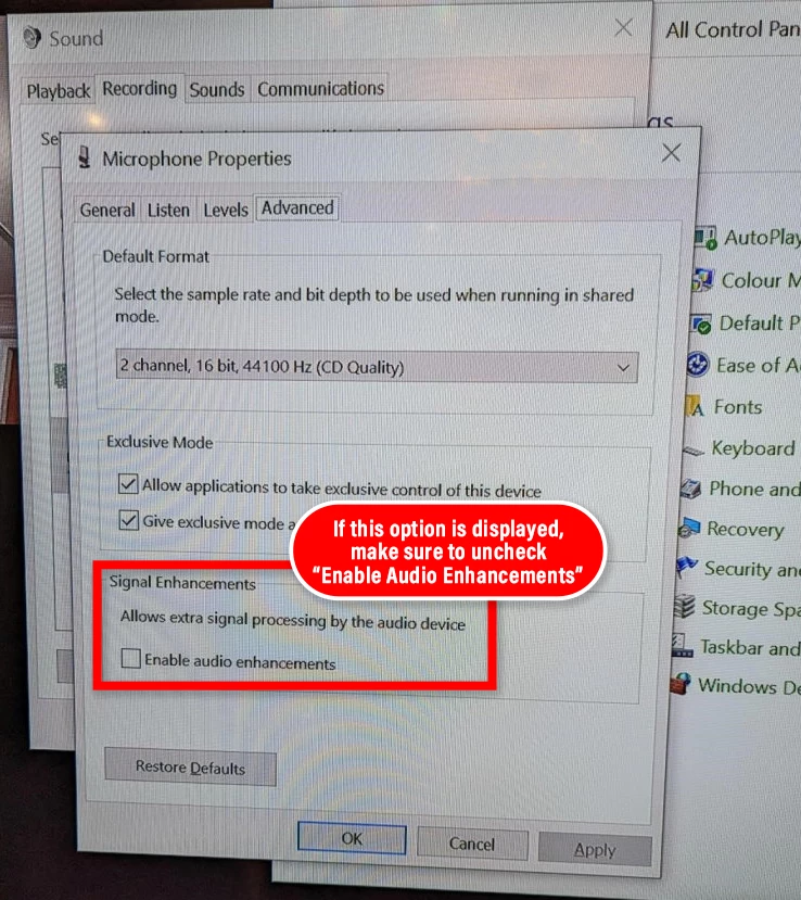

    I've recently found a post on another forum that spoke about their resolution to the "Original Sound" issue. This post is specific to Windows computers, only. And this solution is also specific to their environment, not all environments are equal. But, I believe it's worth giving it a try.
    You may or may not have the option that fixed the problem, but let's take a look. Not every mic manufacturer includes this option.
    Bring-up the Windows Run Command by pressing WinKey + R. This will pop-up the Run Dialogue where you'll want to type mmsys.cpl and press Enter. This will pop-up your Windows Sound Properties dialogue window.
    Click on the Recording Tab and find the Recording Device/Mic that has the Green Checkbox on it. This is your default microphone. Click on that microphone, then click on the Properties Button on the bottom-right.
    You should now be looking at a screen very similar to the picture below.
    If you see the section that is labeled "Signal Enhancements" and the "Enable audio enhancements" is checked, it is recommended to try unchecking this box. If you don't see these options, it's only because your mic manufacturer did not include it in their drivers.
    And if you don't have these options I don't have anything further to help you with in this post. When I find more information, I will certainly share it.
    If you find this information helpful, please click on "Accept as Solution".
    If you have further questions, please reply, we're happy to help.
