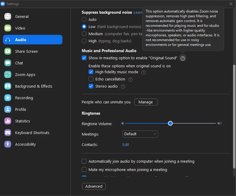

We have to have background suppression set to low to enable the morse code to be heard and all our mics and speakers are working fine when we join the meeting, it is only after screens have been shared that the problems appear.

    I would recommend enabling "Original Sound".
    1. It Disables Zoom Noise Suppression
    2. Removes High Pass Filtering
    3. Removes Automatic Gain Control
    It basically lets the original sound be transmitted without filtering it.
    Beyond original sound I would set some guidelines for the attendees.
    1. When they attend they are in a quiet environment. This is due to the suppression being turned off.
    2. When they attend they wear over the ear or earbuds, and do not use open speakers. Same reason behind it.
    Once you feel like you've got control of the audio, you can then see if you can get by with enabling "Echo Cancellation" for those just in case moments when someone shows-up with open speakers.
