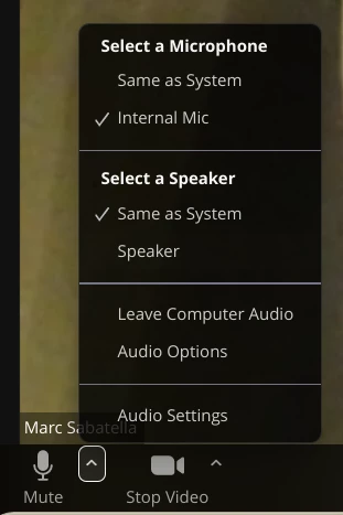

The way to change input devices in Zoom, click the audio icon at lower left:
March 8, 2023
As explained in the original description for the extension, you need to do this after selecting new options within the "original sound" dialog.  Even just changing from "same as system" to "internal mic" does it, so you don't need to actually have a second input device connected.
