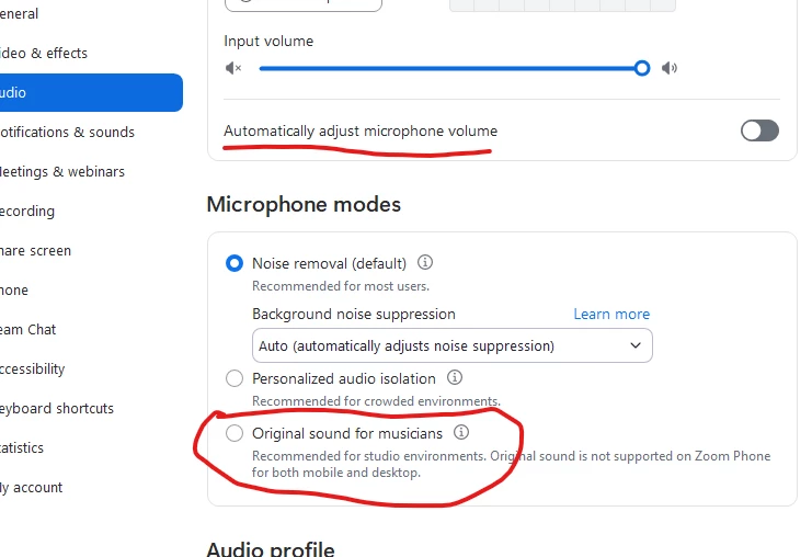

When the ipad is used for sending audio it needs to be set to “wide spectrum” for Zoom in the control center when Zoom is in a session and the mic is on and Zoom needs to be set to “original sound for musicians” in Zoom settings. Wide spectrum can also reduce loudness during receiving audio where voice isolation can boost loudness of received audio for Zoom since the setting in the OSs control center is unique to Zoom. But the Zoom app has no control of received audio.

Firstly there is the setting for “original sound” which will stop zoom considering the music as background noise and cutting it off.
Secondly there is the option to let zoom contorl the volume and this may also change the voloume if Zoom thinks it is too quiet or loud. So, if you want more control you can disblae that too.
