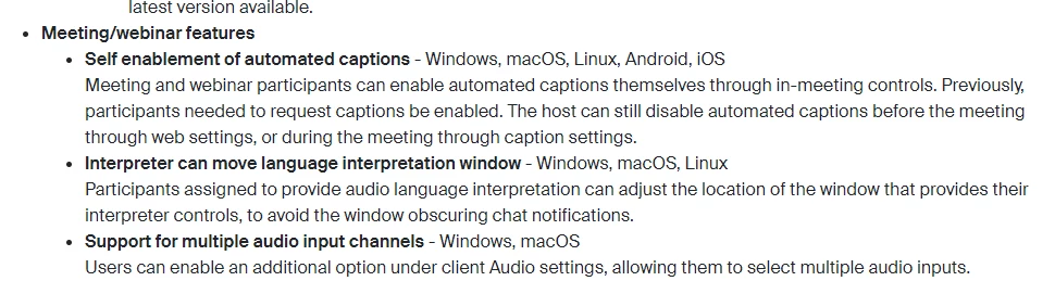

    @GrahamCriddle
    This is now supported if I understand your question correctly.
    Here is where it is mentioned in our release notes from January.
