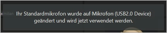

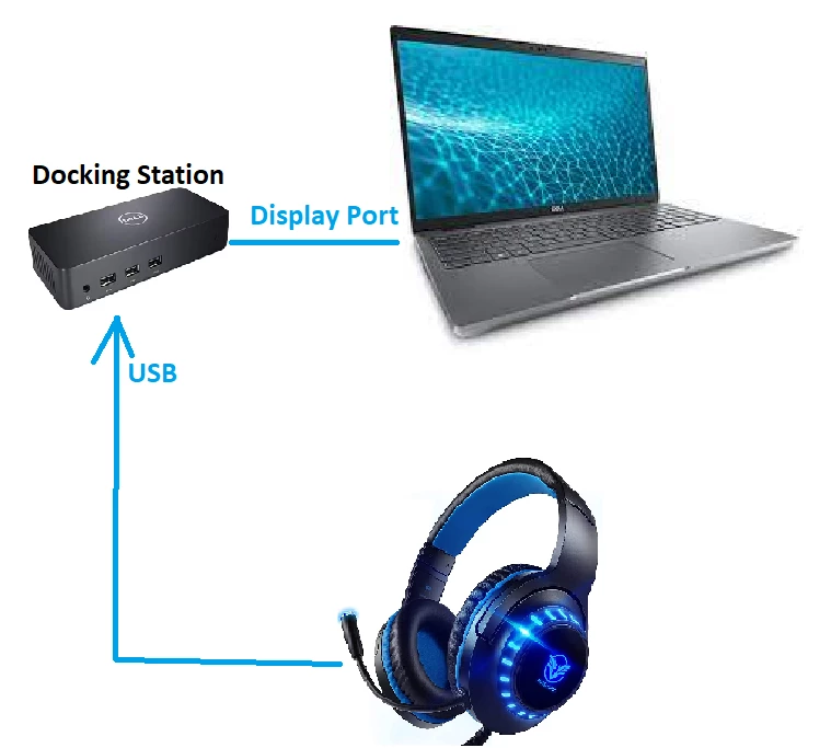

    Same issue with Windows. My Headset is connected with Docking Station. When my desk neighbor in the office speaks, the standard microphone automatically changes from headset to microphone in the notebook. This results in short interruptions and I get a pop-up message (see screenshot). How can I prevent the microphone from being changed?
