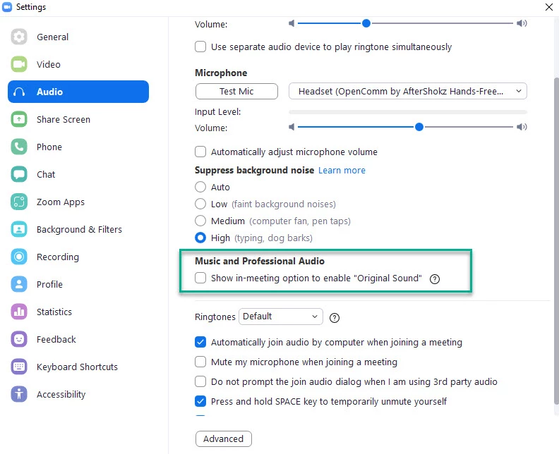

    I would try the following if  you have not already done so.
    In the Zoom desktop client, go to Settings > Audio > Music and Professional Audio. Enable that setting. Enable High Fidelity music mode.

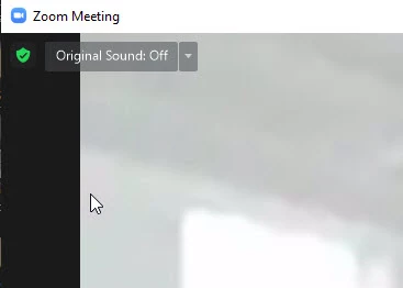

    Once in the Zoom meeting, you can enable "Original Sound" by clicking in the top left corner.
