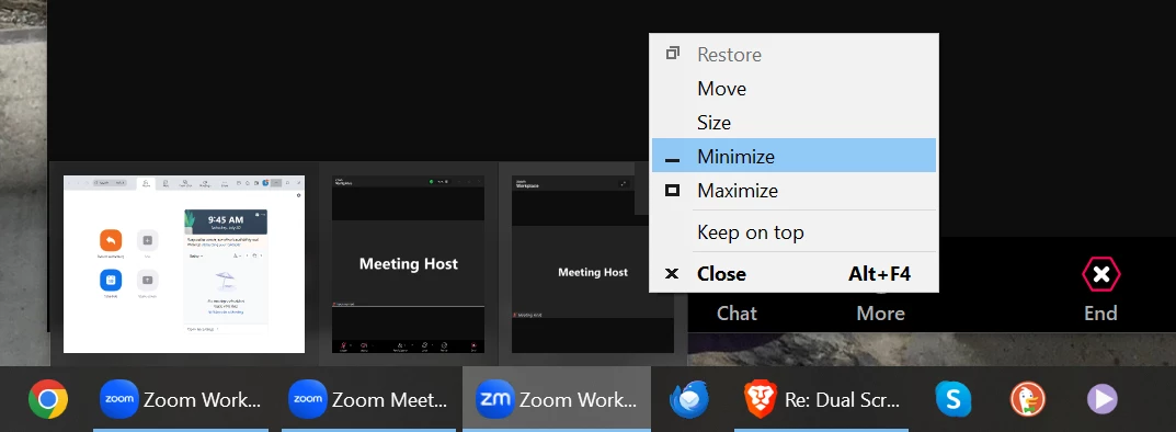

There is another Zoom forum discussing this and no one has fully resolved it yet. This is what has helped us....has not stopped the issue 100% but has reduced how much it happens. This is a Zoom issue seems to be the concensus.
We leave Use Dual Monitors checked.....Before the meeting starts we make sure the 2nd Zoom screen(the one showing the stage and participants) is on the TV's and is maximized. Then in the Taskbar I put my cursor over that 2nd screen thumbnail and when the small preview window appears I slide my cursor up in the preview, right click to get the menu and left click on minimize. The 2nd screen gets pulled back to the Taskbar of the PC monitor. Leave it there until it is time to show that 2nd screen for someone giving a talk on Zoom. When its time for a part over Zoom I remove the spotlight for the stage and I reverse what I did earlier.....slide my cursor over the thumbnail again, slide it onto the preview window, right click to get the menu and left click on Maximize. When that part is over minimize the window again, put stage spotlight on again and click on thumbnail for Year Text.
Now when Zoom decides to take over the 2nd screen, which usually happens during a song, it only shows a black screen and we just quickly click on the JWL thumbnail to bring it back.
With a little practice it can be done very smoothly.

I have screenshots of what we do but unfortunately cannot upload them.
October 17, 2024
Hi, is it possible to send me those pictures on my email?
October 18, 2024
I would try to send to your email.
October 18, 2024
send me your email
October 18, 2024
October 19, 2024
Sorry......but the email is not able to be seen......Zoom is blocking it......but I am able to load those pics now. Read my previous message and I think you can follow what we do.
