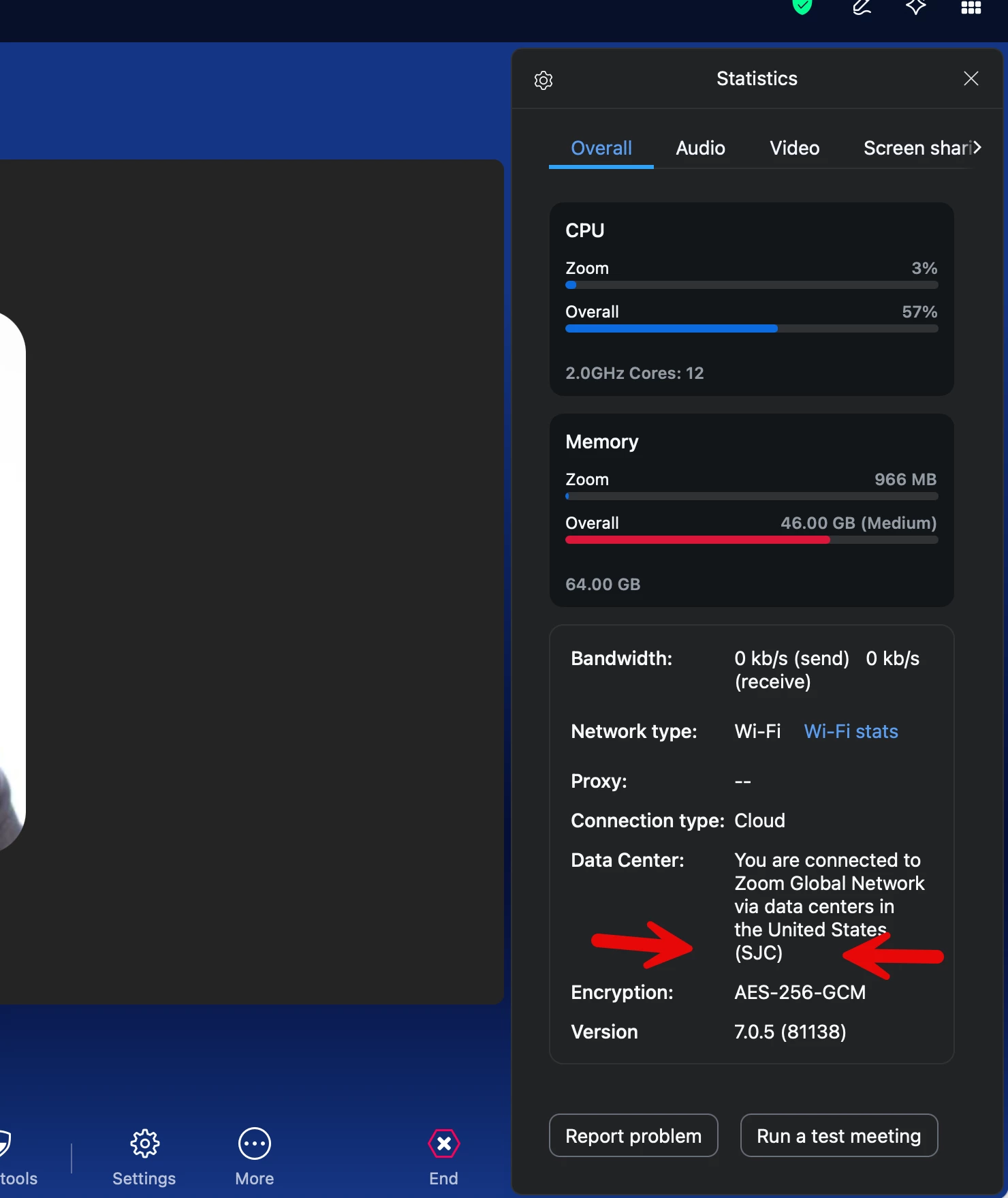

For me, the reason that VPN appears to resolve things is that when I enable Full VPN I’m connected to a different Zoom Data Center.
  • Normal Cox connection without VPN goes to SJC (San Jose) - terrible issues, especially with jitter, lagging, sharing, etc.
  • Cox connection with Full VPN goes to IAD and (other than a bit of VPN lag) works Great!
I also will on occasion use my iPhone hotspot instead of Cox. Interestingly, this still connects to SJC, but doesn’t have the severe jitter/lag that I get with Cox.
For me, it seems like the issue is the combination of SJC and Cox together.
Time permitting, would be great to hear if you’re also connected to SJC with your Cox connection, Alex.
You likely know this, but Data Center is available by clicking More | Settings | Statistics.
Thanks!

Unfortunately, I am running a Mac version of the Zoom app Data Center doesn’t appear on the “Statistics” tab. Maybe is managed by my IT org too.
Is IAD, Washington D.C.?
I’ll try to connect to Austin and see if the issue gets a little better and report back.

  1. Ethernet connected (no VPN) - VERY BAD - Automatically connected to SJC Zoom data center. Viewing the recording shows terrible camera video (very pixelated) and very delayed screen sharing (recording missed most of what I shared on screen).
  2. Ethernet connected (Full VPN) - GOOD - Automatically connected to IAD Zoom data center. Recording quality was good for camera, audio, and screen sharing.
  3. Ethernet connected (no VPN) using Zoom “Web App” (vs full desktop app) - DECENT - Web App does not show which Zoom data center is used. Recording quality was good/decent for camera, audio, and screen sharing.
  4. iPhone hotspot using using Zoom “Full desktop app” - GOOD - Automatically connected to SJC Zoom data center. Recording quality was good for camera, audio, and screen sharing.
Net-net, feels like for me, the combination of Cox ISP connecting to SJC is where the the problem lies, since IAD works, and switching to TMO hotspot through SJC works.
