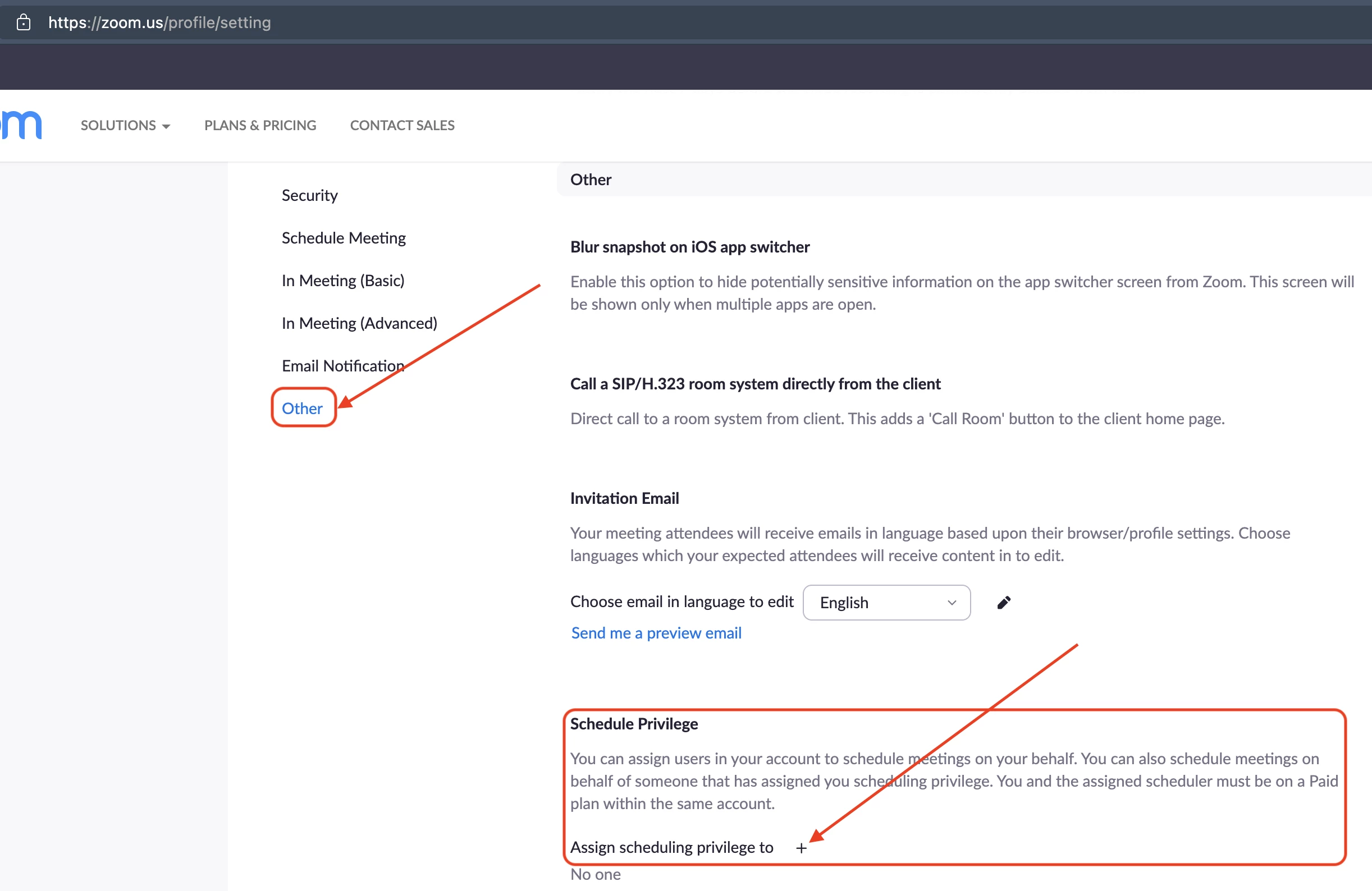

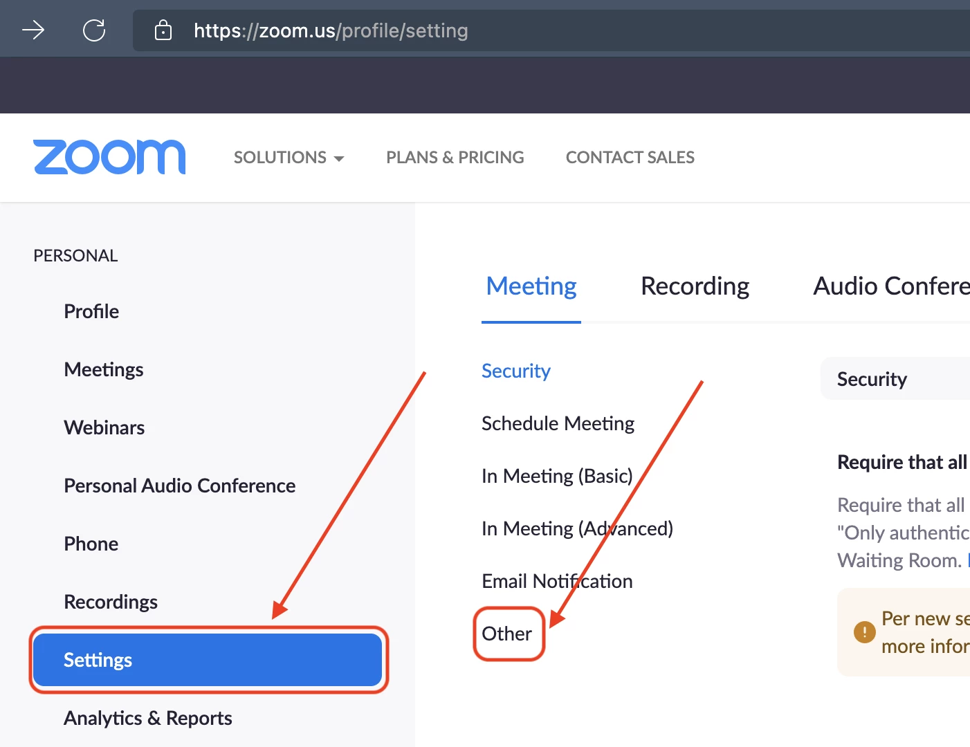

    Just to confirm the process.  Try and follow the below and see if this helps.  Just want to try and make sure she did get to the right page.
    She should click on this to go to her profile page.  Please make sure she is correctly logged in on the relevant account:
    My Settings - Zoom
    And then click on:  "Other"
    Then the "Schedule Privilege" field should be on the right, slightly down.

    Thank you! The issue was solved. We found the right setting and were able to adjust the host of the meeting. By the way, the name of the setting was "Schedule for", not "host".
