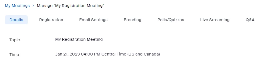

    Have you "Checked" as it's ON - Registration Required of have you "Unchecked" as it's OFF - Registration Required?
    If you've checked the box and registration is required, you go to the Zoom Web Portal, click on Meetings, click on your meeting in the list on the right, and along the top you'll see "Details" - "Registration" - "Email Settings" - etc.
    Click on "Registration".
    Note: This is a fresh new layout. Registration details used to be located on the bottom of all the meeting details.

    February 9, 2023
    When you go to the Registration page as described below, you have to do one more thing - over on the right side, click on "View" and a box will pop up with the name and email of the registrants.
