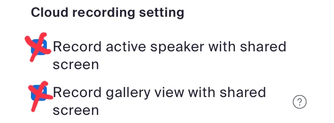

Be aware that there are two separate recording paths: one to the Zoom Cloud, one to your local computer. There is a separate set of recording settings for each of them.
The Cloud recording is controlled from your Zoom Web Portal at https://zoom.us/profile/setting?tab=recording in the Cloud Recording section. Look specifically for this highlighted setting, which will create a separate MP4 with a clean share-only view.
Just above that are two other options which, if unchecked, should remove any overlay of the screen share by a speaker.

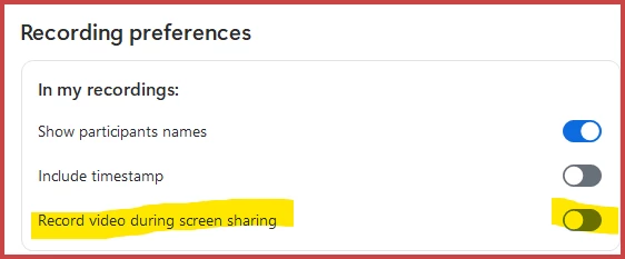

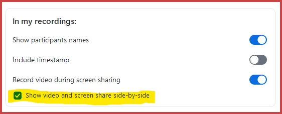

The Local Computer recording is controlled from the Zoom Workplace app’s Settings > Recording tab.   Here, you have two options:
  • No speaker or gallery with screen sharing:
  • Put the speaker video to the side of the shared screen:
Enabling Record video during screen sharing and unchecking Show video and screen share side-by-side is what gives you the camera overlaying the screen share in the upper right corner.  If you are getting this layout with any other setup, I don't know what to say other than "something isn't right."
