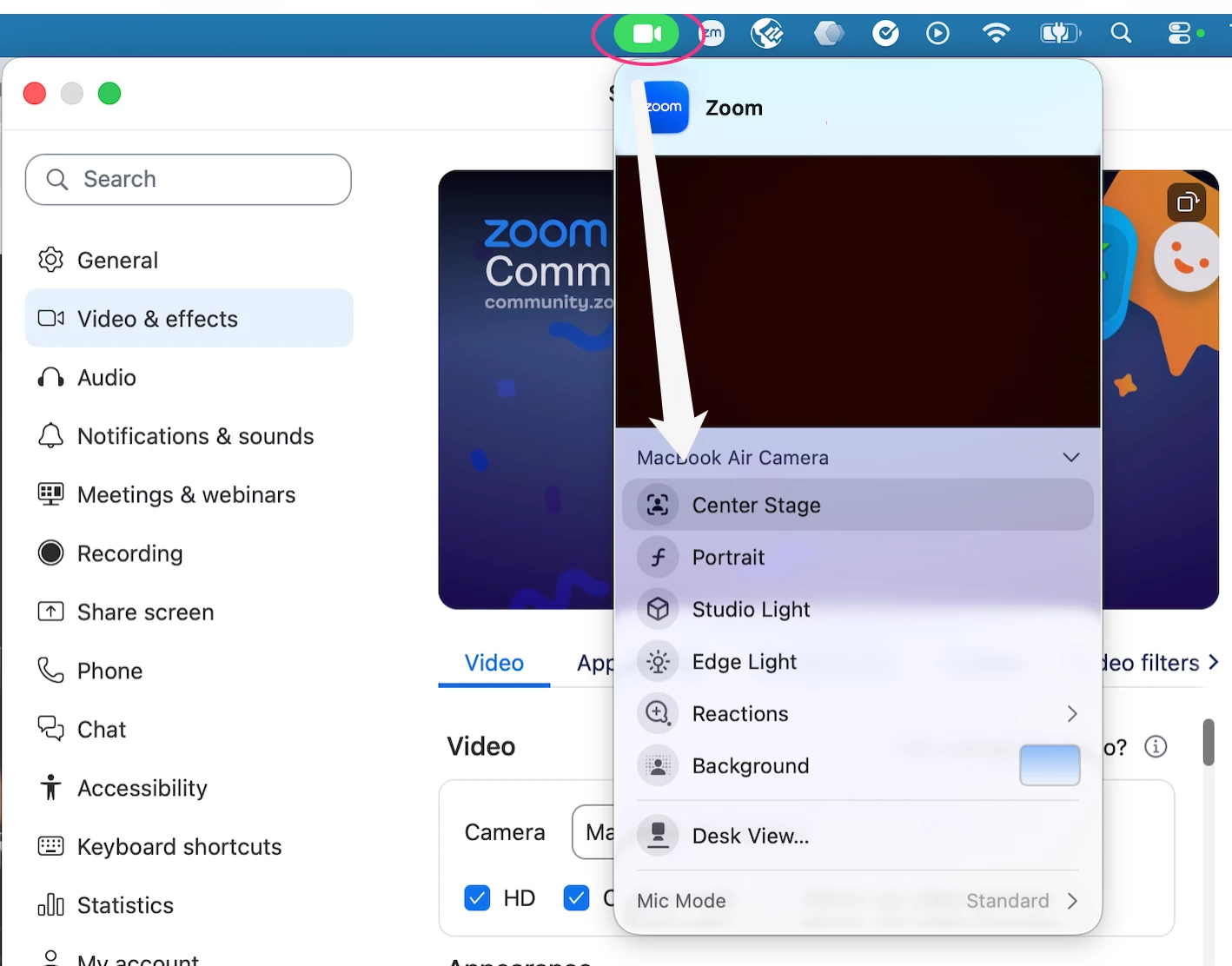

I had solved this at one point, but it’s back, and although on a MAC, I do not seem to have anything called, “Center (or Centre) stage.” I’ve toggled the auto-framing OFF, and there’s nothing in my FaceTime settings that seem similar. I’M STUMPED! HELP!
Jul 1, 2026 9:55 PM UTC
Hello, ​@Shelli727! Welcome to the Zoom community!
You may try these steps :
  1. In Zoom, go to Settings > Video & Effects.
  2. Make sure your camera is turned on.
  3. Click the green camera/video icon in the menu bar at the top-right of your screen.
  4. Find Center Stage in the camera controls.
  5. If it's turned on, click it to turn it off.
Jul 1, 2026 10:00 PM UTC
Many thanks. That’s been off, but the camera still wanders around during meetings - I’m STUCK!
