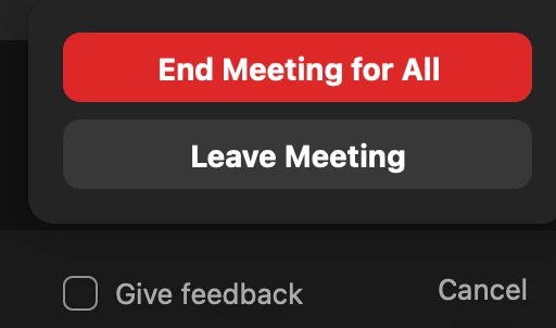

Aug 2, 2023 8:06 PM UTC
I'm pretty sure this is what I usually do.
However, even if someone were to close the window, the same "End Meeting for All" dialogue appears, so in either case, I have confirmed "end meeting for all" and am receiving the error about still being in some other meeting.
Ex:

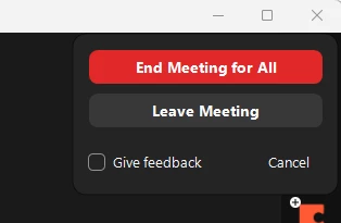

Aug 2, 2023 9:42 PM UTC
I'm not sure using PMI is a solution -- seems to add a new task to scheduling that may lead to more mistakes. I'd rather my previous meeting always end when I join a new one -- like stepping into a new room.
We tried a few tests with different accounts today, and found an odd inconsistency. In these scenarios, a meeting is scheduled for me by an assistant -- I can see the meeting in my Zoom app as upcoming, and within the zoom browser login under user>meetings.
With a couple similar meetings scheduled for me like this, I tried joining/leaving each.
Sometimes, the dialogue that appears when I click leave says "End meeting for all" and other times it's "Leave Meeting."
The "Leave Meeting" seems to suggest the previous meeting I hosted is not ending. I found some support docs saying I could designate a new host, but I didn't get that option, and would skip it if I did.
What would cause the message to be different for two meetings scheduled the same way, with me as host?
Aug 18, 2023 3:44 PM UTC
Adding a little bit:
If you don't see "End meeting for all", it means you are NOT host, and that the meeting will continue without you and you will not be able to start another meeting. If the Host does not "End Meeting for All", the meeting will not end until the last person leaves (which might not happen if someone just leaves the meeting open and goes elsewhere).
Some circumstances that might result in you not being host and thus not seeing "End Meeting foe All":
1. Multiple people log in using the host account. The first person in will be host, but if that person leaves, the other person will become host.
2. Making another person host.
One solution might be to re-enter the meeting, which will allow you to re-claim host and then "End Meeting for All".
All this assumes you have a reasonably current version of Zoom.
