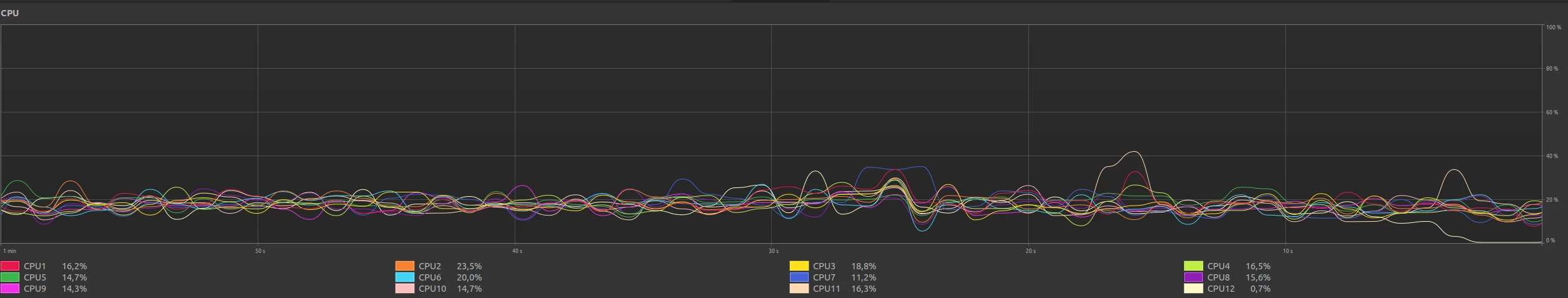

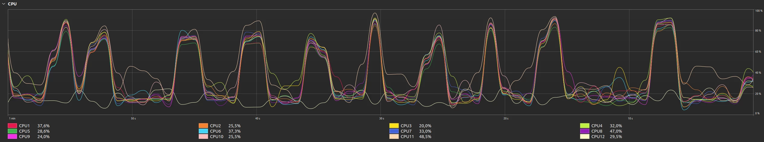

This is my CPU load when the camera is turned on:
And this is the CPU load when the camera is turned off during the meeting:
