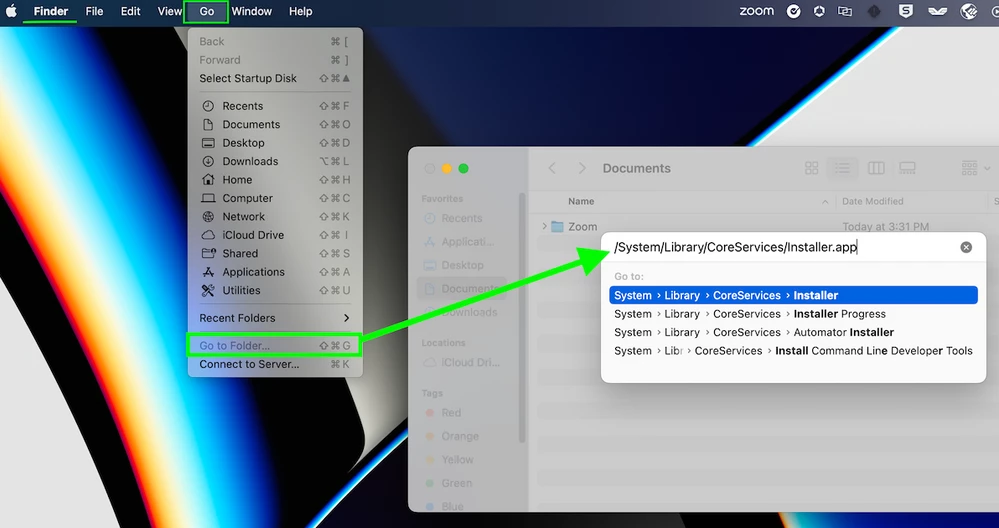

     Note:
    If the installer is not seen at the above location, please add it manually by going to Finder > Go > Go to  Folder...- key in /System/Library/CoreServices/Installer.app and then add the installer once the option is listed.
    I hope this helps!
