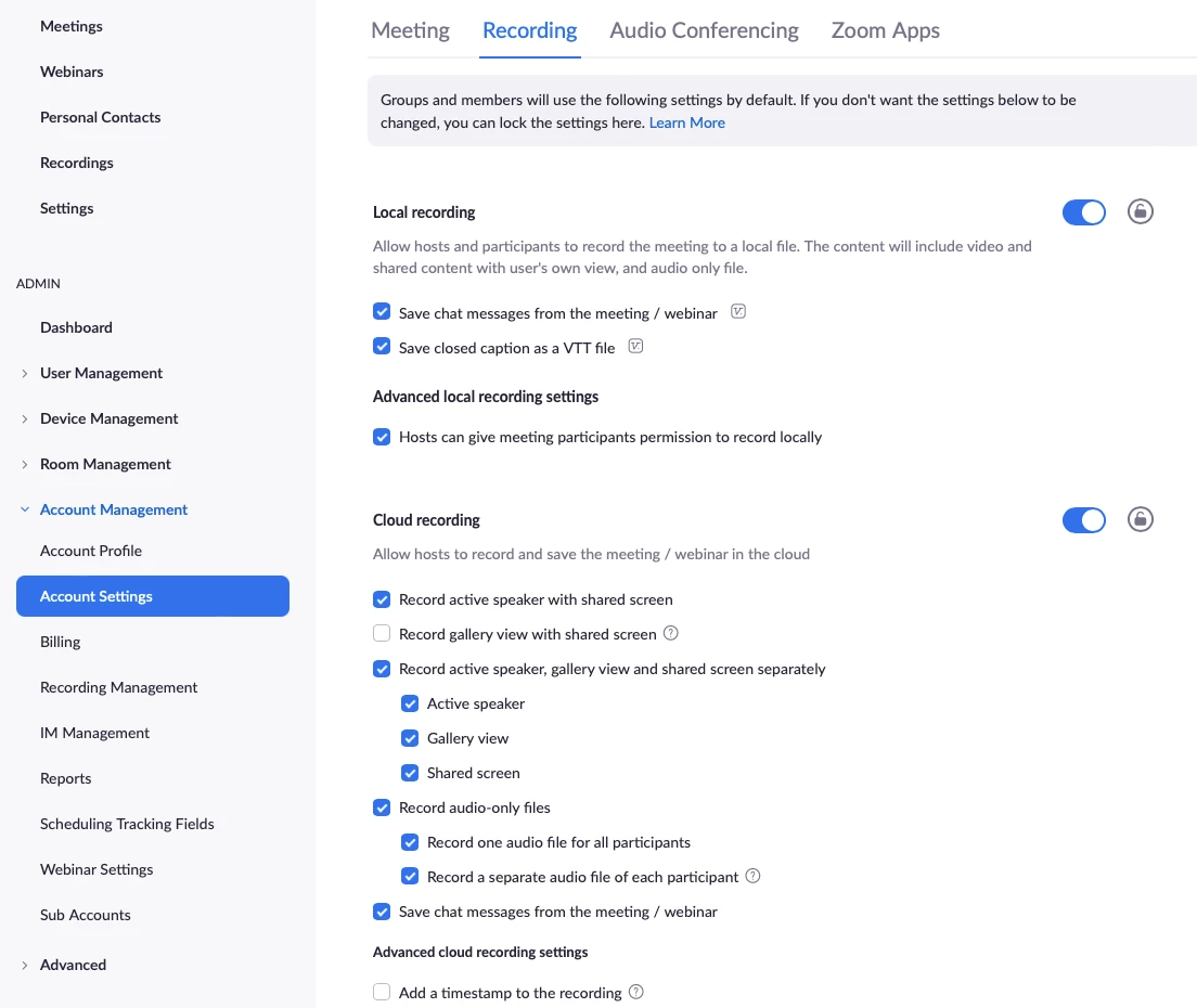

Check your Recording settings via your Zoom portal in Account Settings, Recording. Check if Record active speaker with shared screen is enabled. You can select multiple options too; Record active speaker, gallery view and shared screen separately is very useful if you want to compose a training video yourself afterwards. You can even Record a separate audio file of each participant if you want.

Unfortunately, those solutions aren't relevant to my situation. I already have Record active speaker with shared screen enabled. My problem is how it records the video when my screen is NOT shared. I do not want separate video files of the active speaker, gallery view, etc., as I do not want to create a training video after. Recording separate audio files also doesn't help me either. I need to be able to record both my client AND myself in the sessions.
