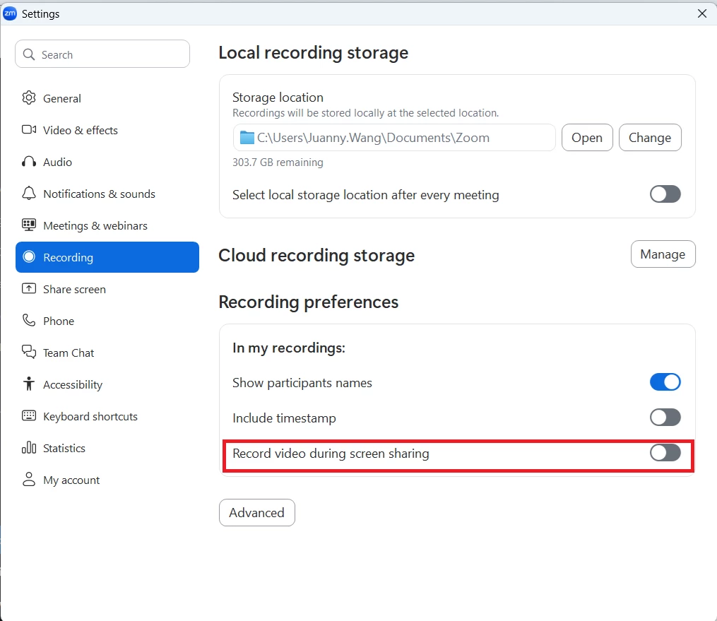

@YaBoiB  has reached out internally to our engineering team. Here is their advice:
Could you please go into your client settings:zoom client->settings->recording
And disable the option "Record video during screen sharing"
Please let us know, whether that helps
