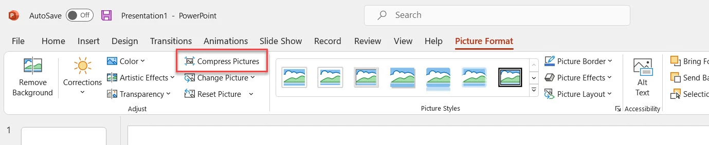

    Nick, I think I can help. Without having to replace all your images in your PPT. Save your PPT with a new name - I don't want to mess up your original.  Check the file size of your original PPT so we can see much it was compressed.
    1. Open PPT you just saved.
    2. Click one image
    3. Picture Format tab should appear in the Ribbon (see attached image)
    4. Click Compress Pictures (see attached image)
    5. Uncheck Apply only to this picture
    6. Click OK
    7. SAVE
    Check your PPT file size
    It should be substantially smaller than your original PPT.  Let me know if this works.

    Hi Chris, thanks for this suggestion, it certainly reduced the file size considerably - sorry it took me a while to get back to you as I couldn't find the 'compress'  button on my system (tracked it down as it had not been added to the quick access tool bar.) Once found, it worked just as you said and has taken the presentation from 223Mb down to 49 Mb. I don't know yet whether that will speed up the slide changes in the presentation on Zoom.  So do you think this will have made a difference to the transmit time? I confess to not knowing how Zoom transmits the data (as I said above, is it really just a series of live screen shots or does the Powerpoint data get uploaded?)
    Anyway, thanks for the help - I will wait and see if it has solved the time lag. Nick
