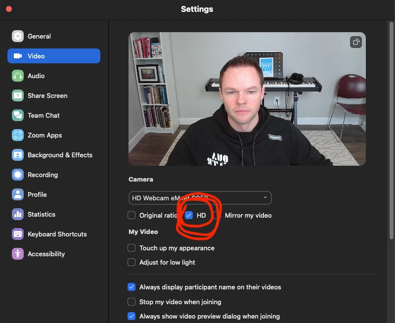

Had similar issue of no video. For me solved it by going to video settings in Zoom and check box HD
This was after hours and hours of trying uninstalling zoom and installing the latest Zoom again and then uninstalling and installing a previous version of Zoom. Also ordered two new C960 webcams which had the same black screen issue -- returned them to Amazon.
March 4, 2024
This totally fixed it for me! Thank you @Geraldca!
@regexAZ, @sczoom, @bstrelko: this made my Emeet webcam work. Settings>Video> check "HD"

Thanks. The Checking HD in the video settings did the trick.
Thanks so much
March 18, 2024
Zoom => Video Settings ==> check box HD

clicking on HD box in the video settings fixed it for me too!
April 3, 2024
I have the same camera with the same issues. However, I cannot select the HD box in video settings. It's there, but the box is greyed out.
April 8, 2024
I am having the same problem but there is no HD option to click on.  Are there any fixes for this as I have a EMEET C960 camera.
