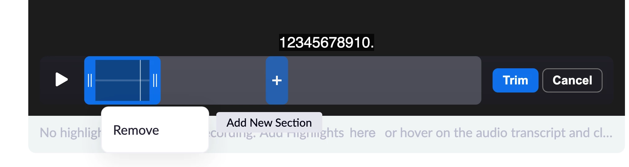

I set up a Zoom I hosted to automatically record a meeting, and it did so. However I'd like to edit out the first 10 minutes of the meeting (which was random discussion and not related to the topic of the meeting). When I viewed the recording and clicked the scissors at the spot where I wanted the recording to begin, it looks like it wanted to cut the rest of the meeting, rather than what was prior to the cut. Any suggestions on how I can edit out those first minutes of the recording?

How to trim the beginning and end of a Zoom cloud recording
Sign in to the Zoom web portal.
In the navigation menu, click Recordings.
Click the meeting topic for the session that you want to trim, then click the thumbnail of the video.
Click Trim.
Use the blue sliders to specify the start time and the end time for the trimmed recording. This means that the blue highlighted area will be the trimmed recording.
Note: To trim by the second, drag one of the sliders, then click the back arrow icon or forward arrow icon .
(Optional) Use these options to add or delete sections to the trimmed recording:
To add more sections to the trim, hover over the playback bar, then click the plus icon . Use the blue sliders to specify the start time and the end time for the new section. Repeat this section as needed to add more sections.
To delete a section of the trim, hover over a trim (blue section of the recording playback bar), then click Remove.
Click Trim, then click Trim to confirm.
You will see a notification below the video stating that your recording is currently being trimmed. All associated files (audio and transcripts) will be trimmed and the trimmed version will overwrite the original recording file. The original recording can be restored at any time after trimming.
