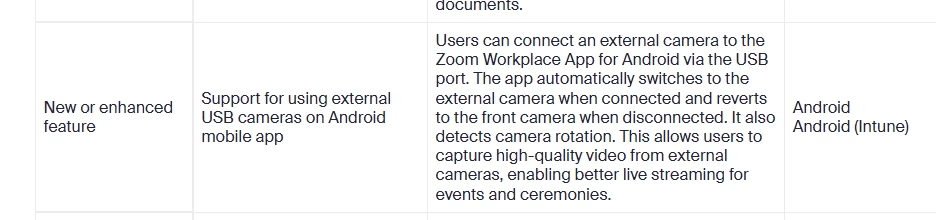

Not sure about those specific devices and PID/VIDs, but USB camera support for Android should technically land on Monday's release of Zoom Rooms 6.3.0:
Talk about convenient timing!
I would imagine that this will be somewhat buggy at first - please post here with your findings - very curious about what devices will actually be supported!
Again, you'll need to be running Monday's release, which generally comes out pretty late in the day.
https://support.zoom.com/hc/en/article?id=zm_kb&sysparm_article=KB0061222
