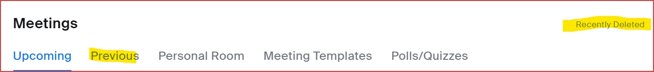

What time of day was the meeting scheduled, and when did the meeting disappear?  Did you check both the Previous list and the Recently Deleted list of deleted meetings?

There is an admin who was co-host of the meeting. The meeting was at 12:30 pm. I am attempting to determine when it was deleted. There is no record of the meeting and no meeting to recover in trash, which I let the chat agents know at the time, and was confirmed by two or three Zoom agents.
