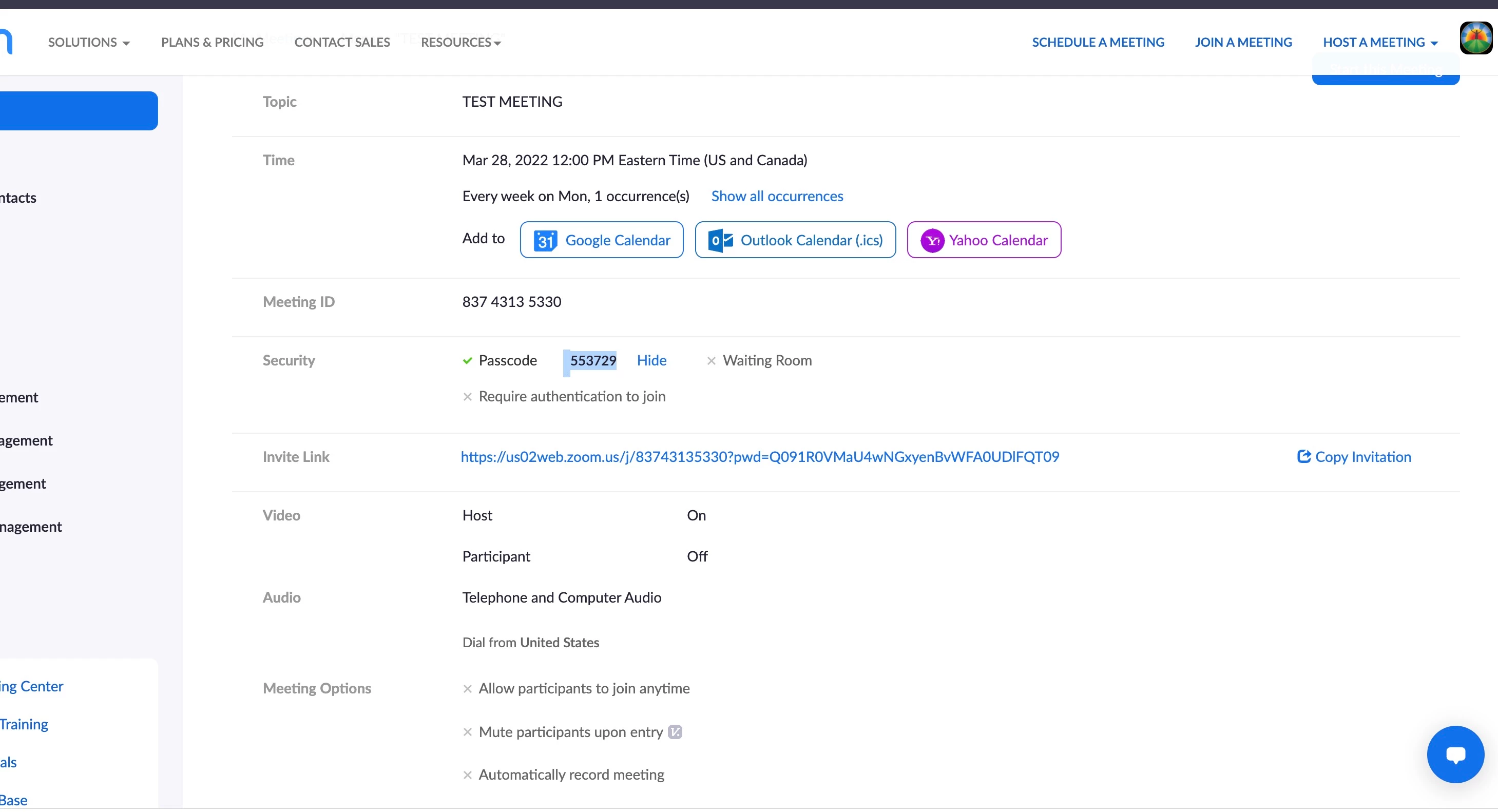

    I'm hating that this is being so complicated/confusing, as I think it's really pretty simple, right? But here's what i've got at this point: I created meeting > recurring, weekly (moot?), 1 occurrence > require 1-time registration > host video/on, participant off (does that mean they can turn it on after they get in there?) >
    Not clear what to do about the b;ue "start meeting" button.
    Should i be able to copy the link and password, then put that in my automated email to purchasers of my course? Wheen I test that to myself it automatcially opens to meeting, I assume because I'm host. I don't understand what the "registration" piece looks like on the invitee's end.

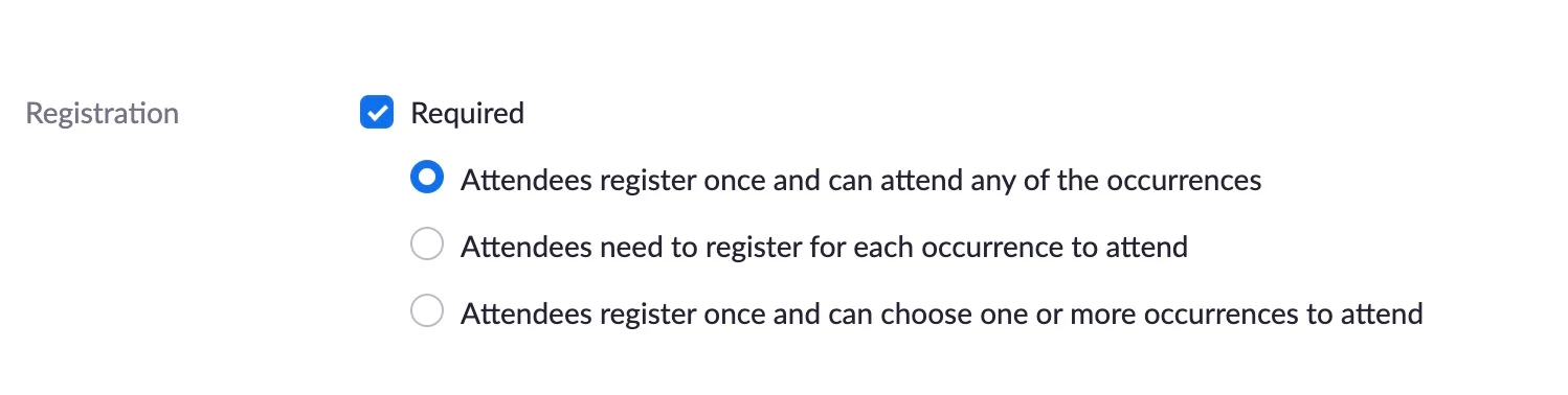

    Mar 29, 2022 12:05 AM UTC
    The attached screenshot shows the three registration options, firstime only, eveery occurrence, or register for some occurrences
    Mar 29, 2022 5:38 PM UTC
    Thank you for pointing me to that option. I see it now. I've been testing it to see it's effect. It doesn't work like I expected it to.
