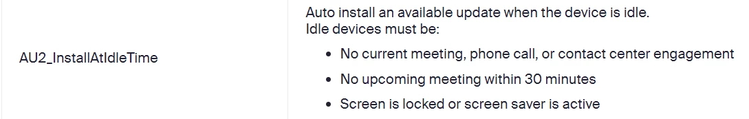

Not an answer, but just want to add that our org has also found the AU2 policy to be unreliable. Note that you have AU2_InstallAtIdleTime set to TRUE, so you'll have to account for the following conditions:
Even with these conditions met (which is asking A LOT), we've still received mixed results.
