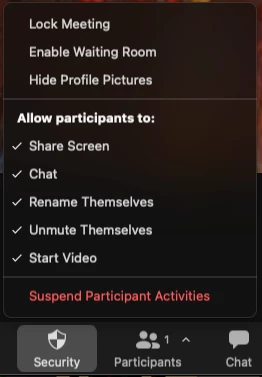

So I was kicking off a free session for everyone available to join my zoom room and somehow my zoom room information was posted on Twitter. People joined and were showing their pen*s and playing p*rn. Definitely not my intention when sharing a meditation for free. Needless to say, it was a big lesson learned. How do I set up a webinar or a meeting where I have an assigned person controlling what is shared.

    Per your question, in meeting you have the option to configure these security settings under the 'security tab' as this should help you out on limitations for participants.
