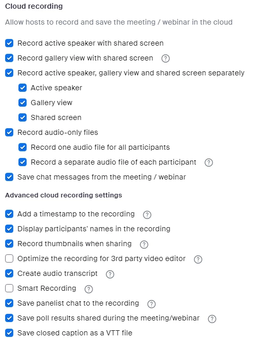

Recently the data used has increased on my recordings to the cloud. My meeting length hasn't changed. Does anyone know why or how I can minimize?

February 22, 2023
@NickDetura
Login into the Zoom Web Portal, go to Settings, go to Recordings tab to see the options.
The selections are

driven by what you want to be available after each of your sessions.

February 2, 2023
With cloud recordings there are several options to select from of what type of recordings you wish to be captured. If additional options have been selected, then the required storage capacity to record those will definitely increase.

February 2, 2023
Thanks Jeff. Where do I find cloud recording options and which ones are best to minimize my data usage without altering the quality video that I am providing my Zoom Fitness Team?

February 22, 2023
@NickDetura
The selections are
