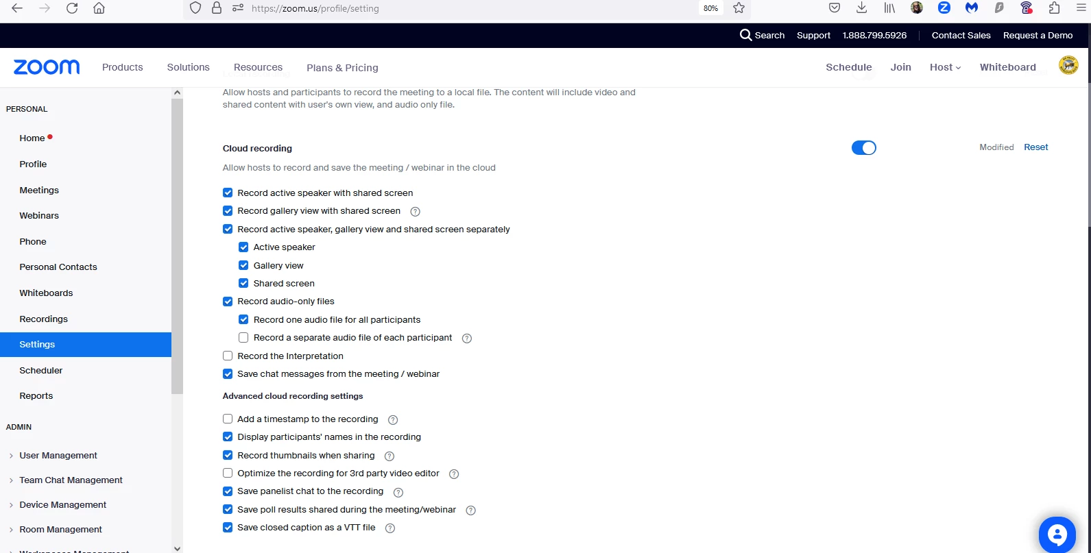

Please provide a screen shot of your Cloud Recording settings. Here’s mine:

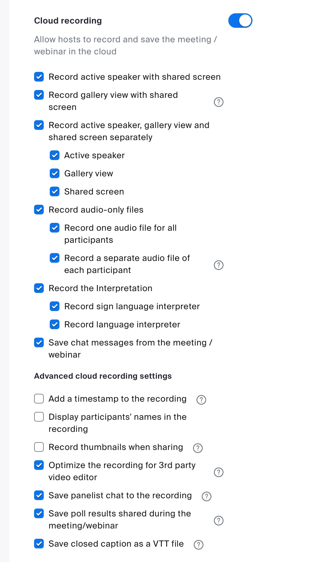

Thanks, @BVBG.
I'd recommend enabling the "Optimize recording for 3rd party editor" option, and making a couple of test recordings.  I've found this optimization tends to solve the occasional problem like yours.  It's possible there is an incompatibility between the "standard codec" and whatever codec is installed in the playback software you use, and the "optimized codec" seems to be "more compatible."
No promises... but there's a good chance it'll work.
I'm assuming you know the various MP4 files that are produced, and you've looked at ALL of them.
